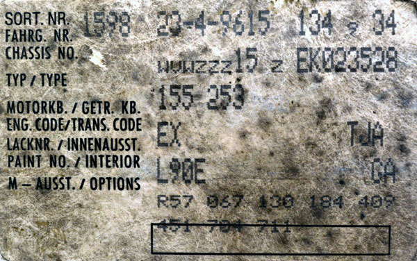

I'm trying to recreate the boot build sticker. The old one has been carefully pealed off before spraying, and is very grubby.
Is there anyone that does these? or, does anyone know what the font is for the left hand side of the sticker? The bit that start with 'SORT. NR, FAHRG. NR etc.

After trying to locate the font, I came up with a couple of possibles, but they were'nt perfect, so I decided to 'photoshop' the 'photo I took. I'm happy with the results, what do you think:
Before
After:
I purposely did it just as the factory, not in the box at the bottom, and using the same techniques with the old style 'dot matrix printer' letters and numbers on the right.
If any one wants the 'PSD' file to play around with, make a template for theirs etc, PM me with your e-mail address and I will send it to you.
Actually, after looking at it on here, I can see a couple of faults, however, when printed off, it looks better!

I did mine from scratch so the font and spacing aren't going to be an exact match. Having said that it's only fractions out and unless your holding the old sticker beside the new (While reading it upside-down in the boot) they're indistinguishable.
This is the font (Dot Matrix) I used for the vehicle specifics - http://eknp.com/fonts/dotfonts1.php but the download's now gone. A quick Google brought up tons more similar freebies.
This is a blank of the sticker background onto which was added the dot matix detail… You might be able to use / refine it.
And here's one of the final draughts. The Sticker font has been darkened / bulked up and the dot-matrix lightened as per the original…

'E' is the year (1983 in this case)
'23 - 4' are the week of the year and day of the week in that order.
Days of the week are calculated from Monday to Sunday therefore Monday is '1', Tuesday '2' and so on. Yours is '4' which is Thursday.
The weeks themselves are calculated from the 1st January regardless of what day of the week this falls on.
In 1983, the 1st January was a Saturday, but that doesn't matter. It's the week, in your case Monday 27th December - Sunday 2nd January that counts. (Remember the same week will be '52' for 1982 cars.)
Count forward though the year starting from 1, so the week Monday 27th December - Sunday 2nd January is week 1 not 'Zero'.
Your car was therefore manufactured on Thursday 2nd June 1983.

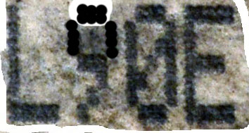

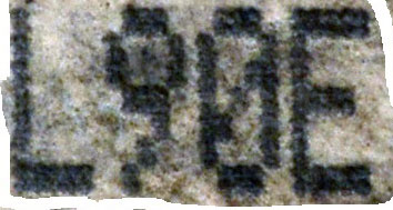

The dot matrix font is 'perfect' and looks very good, however, I was after trying to replicate the standard of the original, and if you look very carefully, the dot matrising on the original sticker is all over the place! it just gives an 'idea' of the original letter or number.
For example:
I'm hoping 'photobucket will load this properly, as I've been having issues with the blurriness on there, but that's another story…
This image is magnified 200%, If you look at the dot's you can actually see slight impressions where the dot matrix printer hit the paper. What I did was to use the paintbrush tool set to 17 pixels (which is about the same dot width) and individually painted a blob on each dot. (some dots are a bit smaller)
Like this:
I reckon by 'copy and pasting' the letters required should give the effect required.
Or, you could take a 'photo or scan and create a new layer, import the scan/photo into that layer, then create another layer in front of that, hide the original and do the 'blobs' on the second layer, then remove the old layer(s) as required.

Does this mean my car was made was made on Thursday 25th February 1983 or have I misunderstood.
Date of 1st registration is 18/4/1983.
Sticker Pig
If you want the PSD Boot Sticker file, it's here: Boot Sticker
9double9 said
http://i1255.photobucket.com/albums/hh634/PGBACON/1ba15a2c-6bbf-4701-83c8-145bfed8a6eb.jpg
I work yours out as Thursday 17th Feb 1983
Sticker Pig
I wonder did VW just sign off cars from the preceding week on Thursdays?
