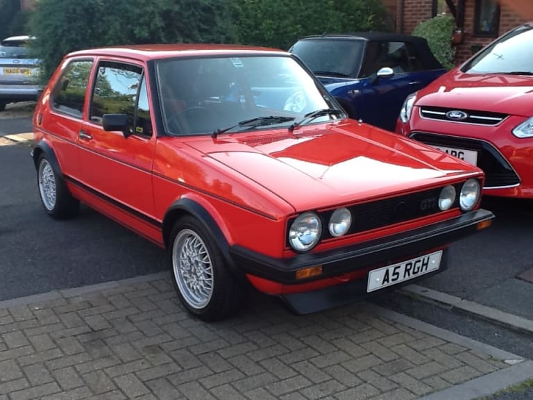

Preparation is the key no fancy wax is going to look it's best without the paint being perfectly clean and depends if your car has been resprayed like the original paint in single stage in red was the final coat, or in a modern finish, with a clear coat on top. Single stage is easier to work with and if there is little evidence of fine swirling will respond very well to an old fashioned glaze such as Meguiars #7 rather than any filler polishes I mention below, but it's tricky to use, you will get pretty close to the finish with what I have put below.
Only needs claying if you can feel any contaminates sticking to paint after it's been washed, should be able to feel roughness with your hand.
stone chips you can do nothing about without some touch up paint
Scratches depend on how deep they are, if they can catch your finger nail in them, then pretty unlikely you will get them out without painting first. If you can't feel them, then chance is they will come out, certainly by using a polishing machine, possibly by hand using a cutting paste such as Meguiars Scratch X. You need to be very very careful as too much effort and you could go through the paint.
Unless you have a machine polisher and know how to use it, you will struggle to get the gloss on your paint flawless but there are some things you can do by hand to improve.
Poor wash and drying technique leads to fine swirls in the paint -really noticeable in direct sunlight and under bright lights in your garage. Using a polish which fills these fine swirls will really help - not permanently - only machining will do this though.
You mention Poorbouys on your white Golf, I presume their White Diamond. If you have still got some then this will be fine, I have this and Blackhole and there is no difference. If you have run out then again without spending a fortune Autoglymn SRP will be even better. really work your polish into the paint well, using sponge applicators and removing with good quality microfibres.
Next stage is a coating to protect what you have done and the choices are either a wax or a Sealent. You can spend hundreds on waxes, but much better value ones I feel are Britmax Vantage or Poorbouys Natty's.
However, I don't use any now, I use SONAX BSD - Brilliant Shine Detailer, It's on offer at places like EuroCar Parts for about £6 a bottle at moment. I make a hybrid of this up with Autobrite Project 32, but on its own it's just about as good.
All you do is spray it on lightly, use a microfibre to spread it over the paint and then with a plush microfibre folded several times so it's quite padded, very very very slowly move it over the paint. This is best done in doors as you look a bit of a fool, but it removes any excess product and reduces any chance of streaking. The beauty about this is you can use it to finish the car off again when you get to a show, having taken great care that there is no grit on your paint to rub in - again using plush microfibres will reduce the risk
For the black trim if you don't have any product at moment, I have tried lots but feel you can't beat CarPro Perl. It can be diluted to use on tyres as well.
Rather than ramble on anymore I am happy to chat through with you, send me a PM with your phone number or if you are close enough to South Derbyshire you could even pop over.
If you have time on your hands go to Detailing World.co.uk lots of advice and tips but can get a bit bewildering as everyone has their favourites and some very deep pockets.
