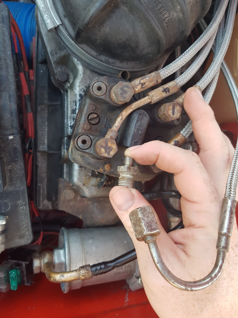

Hi guys, changed a fault WUR 2 weeks ago and whilst tightening one of the couplings on the metering head it snapped (Pic attached). I've been having a nightmare trying to source it. If anyone can point me in the right direction or has one I can purchase I'll offer a more that reasonable price and cover postage.![]()
That's the size dude.. google it, there are some you can buy from abroad I'm sure… also, take a look on eBay & see if someone's selling a FD or meter head & take it off there.. the torque is 10nm, but on an old one I'd say hand tighten… new copper washer & check for leaks… pita

Part #063133541 - 8x1/12x1.5Deandubya said
