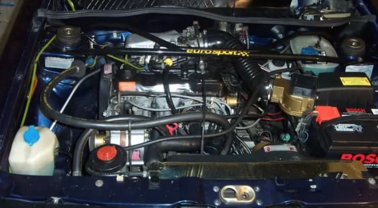

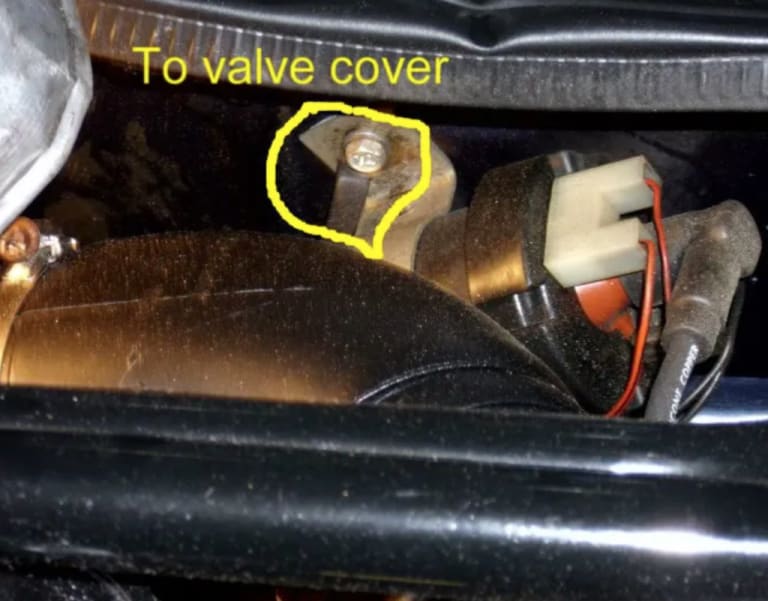

You did run a Ground wire off the Valve cover nut over to the Coil Bracket on the fire wall?
Valve cover bracket on right rear side of the valve cover (
as you are looking at it).
To the Coil Bracket.
Why show Clean Pictures of my engine bay.

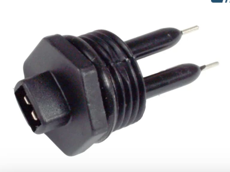

The light could be that if you have a coolant level sender in the middle of the expansion tank may have corroded Contacts they may need to be cleaned with some sand paper.

if the Light flickers, and you have the expansion jug coolant level sensor in the middle, then remove it, IIRC it is either a 28mm or 27mm nut to remove it. A pair of slip joint pliers works too remove it.
The tips of the sensor can get scaled up, and you have to clean them. Also if you aren't running a 50/50 blend of AF/Water in your jug they will flicker the light to say the coolant level isn't correct.
I kept my coolant level to the Seam of the jug where the top meets the body.
On some revisions of the jug, the makers didn't drill a small hole at the top of the level sensor hole below the threaded part, this allowed any trapped air to move out, and keep the level sensor equal. The lack of the bleed hole could cause an air bubble to form and prevent the fluid from surrounding the sensor giving a false low condition.

The Flickering light could be that you have the incorrect gauge for the car. If you don't have the coolant level sensor in the middle of your jug, then you will need to install a resistor between the coolant level input of the cluster to ground to trick the flashing light off.
