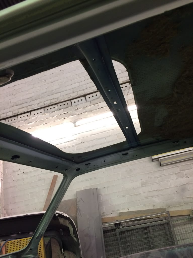

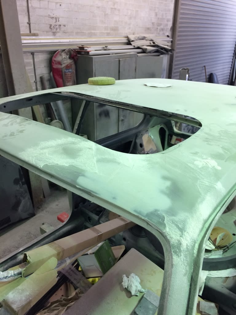

I had mine patched with a plate from underneath, although it was bonded in with a flexible panel adhesive and a few spot welds for good luck, it had plenty of overlap on it. the bodyshop then filled and shaped the recess.
I managed to find a spare cross member for the roof to help strengthen it.
I wasn't that sure it would work and was worried about cracking but wanted to try it before doing a full roof swap. It's now two years in and its still showing no signs of movement.

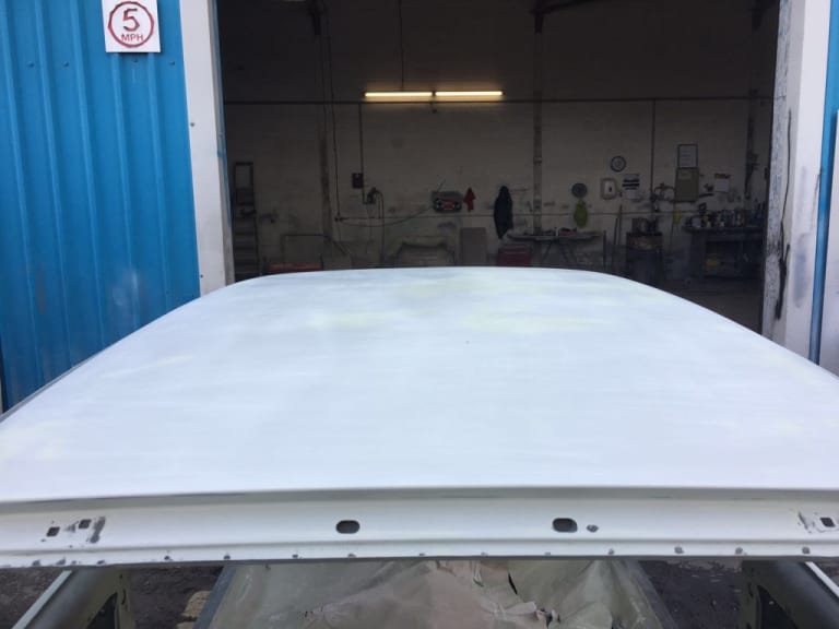

Or you can get it filled in properly by craftsmen so you don't have to rely on tons of filler IMG_5863.JPG
That's the point, I'm curious to ways people have had them repaired or replaced in the past
The car in the image was a 964 Porsche with a lot more curve than a tintop golf. The infill panel is tig welded in flush with the original panel which is an art in itself and then 2 men working from each side with various tools, hammers and guages slowly lift the roof to give the curve. From memory It cost £2000 to do but I happened to see the car at Caffine and Machine last night and 7 years on the roof still looks spot on. There were some recent photos on FB of some so called Mk1 specialists that had filled a roof with filler and it had cracked within 2 years apparantly. This Porsche roof needed next to no filler.
