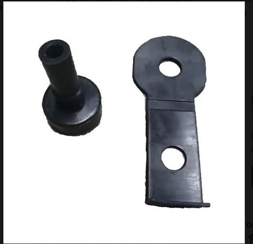

Hi guys. Anyone know how to push the clutch cable through the rubber sleeve
Blob of grease on the end of the cable and it should push through.
If still no joy try and warm the rubber up by leaving it in some hot water for 5 minutes.
