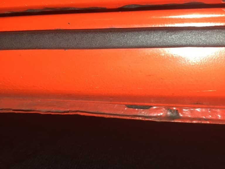

The front valance stone chip goes right up to the cut outs in the valance behind the bumper, and if I am honest the small strip of metal underneath the bottom of the grille does seem a little thicker. On the front lower quarter of the wings, the stone chip goes up behind the bumper.
On the sills the stone chip goes right up to the top of the black clip on trim, in fact even a few mm above it.
At the back the stone chip,goes right up to the horizontal crease that just about lines up with the holes where the bumper irons go through, it's also much heavier the lower down the valance you go.
Fro the rear wings, just like the front the stone chip goes up to behind the bumper.
Texture wise it's smoother than Hammerite apart from as mentioned the lowest part of the rear valance where it's quite rough textured.
