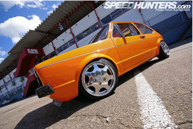

something like this
A 15mm adapter will make them et37, personally I'd buy 6's and 7's as you've more room for manoeuvre.
That thing up there has rubber band tyres, camber and definitely had arch work.
