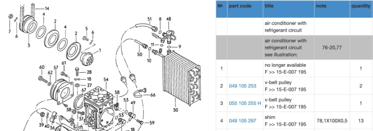

If you are talking about the shim on a York a/c compressor then look to the ETKA, 84-89 Cabriolets used a york compressor and a shim to make the belt tighter.
The etka
https://volkswagen.7zap.com/en/usa/rabbit+conv+golf+cabrio/conv/1990-44/2/260-76000/
