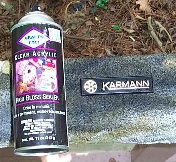

I have re-claimed mine a couple of different ways.
1. Sand and clean the whole Badge.
2. Paint the While Badge to the color that you want, ie: chrome, white, Red…..
3. After it was dry, then spray with 2-3 coats of clear.
4. After the Clear dries Paint the whole badge with Satin Black .
5. Using 2-3000 grit wet/dry in a pan of water, turn the badge face down, and sand the black off the face a little at a time, the clear coat will keep the base color white from sanding off.
Second way,
I sprayed the badges sating black 3 coats.
I then Gold Leafed the raised letters with gold leaf adhesive, and Gold leaf. I used a specific clear over them as the regular clear reacted with the leaf it lasted about 12 years before I had to re-do them.
Here are the pics of both ways, The white ones werr as described in the first, they were also glued using clear silicone,,,,,Yep it was totaled.
I have a how to in the archive section on Gilding the badges.
