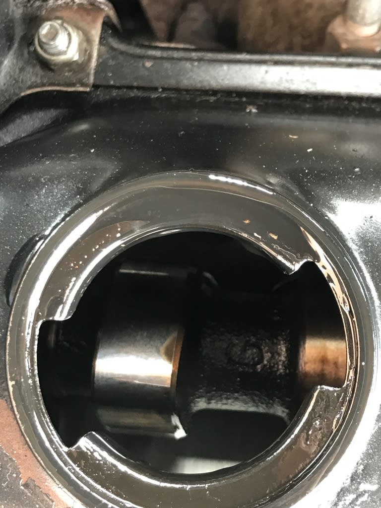

Went out for a drive today, got back and opened the oil cap and noticed some strange wear on the side of the camshaft
All ok or further investigation needed?

newer oils don't have the Zinc content that the older oils (dino have) and can lead to wear on parts.
So the addition of Zinc additives to the oil can eliminate that.  The picture doesn't show that much wear to me, so I need more clues as to what the wear is.
Do you have hydraulic tappets or shims?
Hydraulic heads have 4 cam shaft caps and shims have 5 caps.
If you have shims you car check the clearance between the tappet and camshaft lobs, all explained and gaps needed are in the haynes manual.
They are shims, car is April 83
The wear I am concerned about is in the photo right hand side behind the lobe
Looks like part of the cam has worn away but dont see how that would come into contact with anything
the edges of the cam are chamfered they look like that.
I thought was a shadow on the picture… Don't worry about it as it's not touching anything…
As you don't seem to have one, it's worth fitting a oil deflector which stops the oil splashing on the bottom of the rocker cover and breather hole/gauze, it just sits ontop of the cam shaft.

Was going to say being an 83 car its a 1.8?
It should have a splash guard under the rocker cover anyway so you cant even see the cam

Have ordered a splash guard and have the cam cover off
Had a thought about the wear is on the cam and could be for balancing the cam?
Just need to get the tools to change the shims, cant find one anywhere apart from USA

Have you checked the gaps?
Make a note of all the gaps before changing anything.
I changed my shims by removing the cam shaft completely, (cam belt off and undo the cap nuts the right order to stop bending or cracking the cam shaft, info in Haynes.) I only had to replace a couple and the hardest thing was seeing the size numbers on some of the shims so had to use a micro meter to measure them and work out what size shim I needed.
I've also made a note of what tappets are currently fitted so when they wear I can work out what size I need to replace them with.

So started to have a look at the gaps after work today.
Cylinder 1 Exhaust
Cam lobe pointing up to centre of cam cap
Cant even get a 0.10 feeler gauge under it!
Should be 0.35 to 0.45

Bit of an update
Due to only 1 shim being within tolerance I have removed the camshaft and replaced all 8, new seals and gaskets
New cambelt as well

All done ✅
Test drive next, sounds better, feels more responsive on the throttle and smoother tickover
