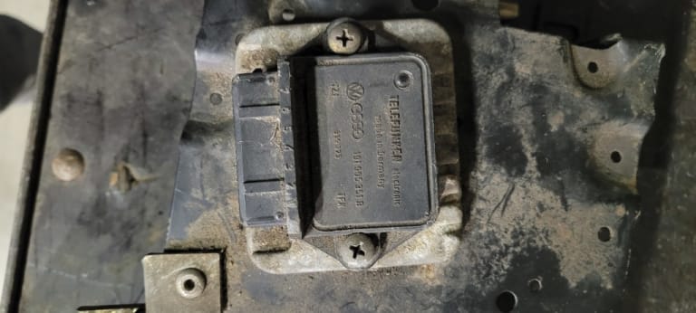

My buddy and mine full rebuild caddy ran into some issues …
We currently struggling to find a decent fuelsetup for our RP mk2 engine .. i know that a caddy doenst have a liftpump neither a hp pump.
Is there anyway one of yall can help us out regading this issue …
Much apprecation
If so no lift pump in tank needed.?
mark1gls said
Not sure on the engine so checked online and is RP engine a 90bhp carb feed engine?
no a RP is a monopoint injection … and yes 90hp
The Digifant ECU's are labeled as Digifant 1 or Digifant2
Pictures go a long way.
The year of your Caddy tells us a lot more than just a Caddy.
Help us assist you better, the more specifics, the better.
