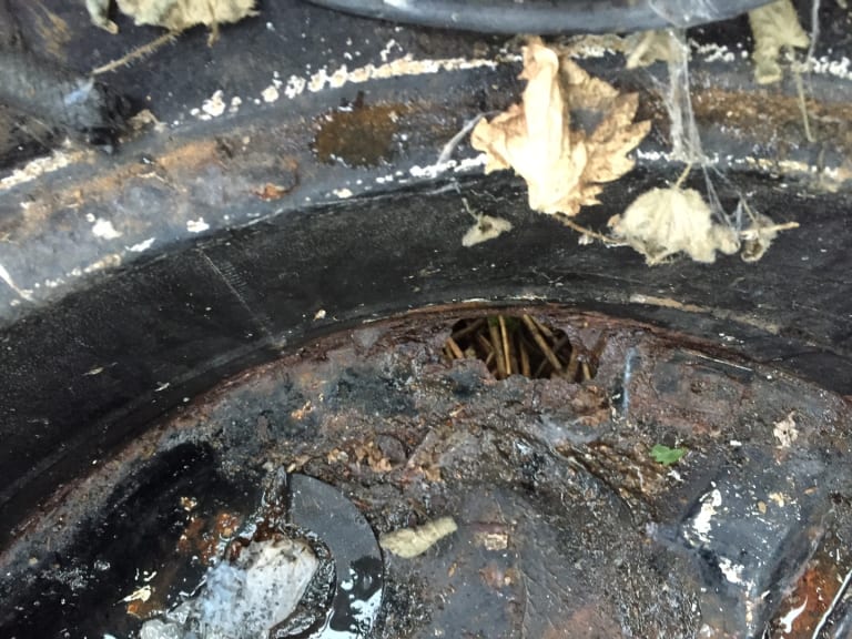

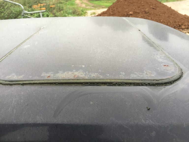

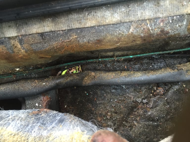

I've had a look round it and from what I can see the body is fair but solid and so far as I can see and feel, the underside is pretty solid as well! It has a hole in the spare wheel tub and a small hole in the passenger floor pan just in front of the cross member where it joins the inner sill. There is also some rust around the factory sunroof, which does concern me, see pictures for these areas.

Just from those couple of pictures which is only a very small % of the car.
I think you have a full restoration project on your hands but others may disagree.
The only advice I can give is be very, very careful.
Please don't let your heart rule your ability or your finances!
Good luck but if we could see much more of the car, in out and everywhere we'd be able to give you a more informative opinion.

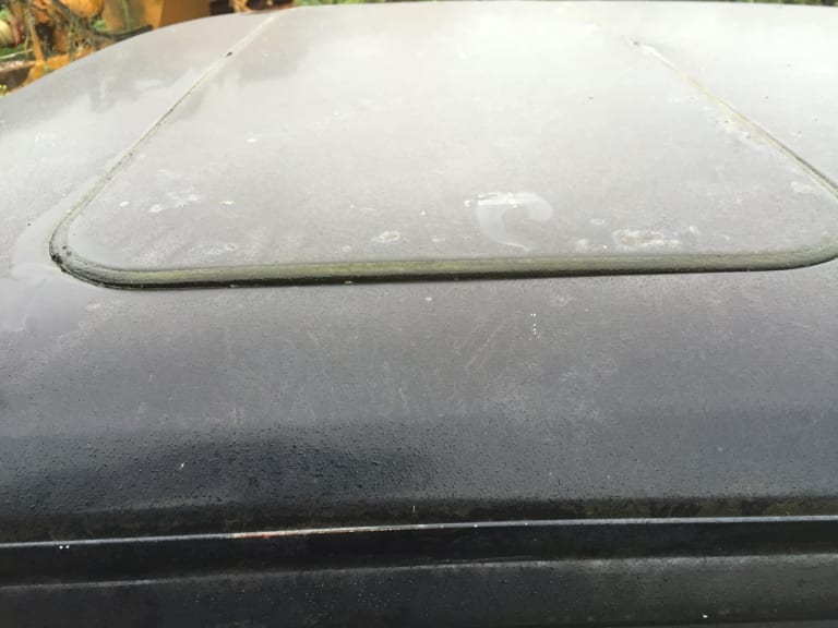

I posted those pics to show the areas that concern me the most so far, the roof/sunroof in particular do worry me because repairs there could be tricky if the rot has come from the inside!

Can anybody point me in the direction of photos of inside the headlining to give me an idea of what is in there and where the rust starts? Also, were these sunrooofs til and slide or just slide? It's a Y reg 1983 model with a factory sunroof.

Just slide. Tilt and slides could be fitted from Audis and some roccos.
