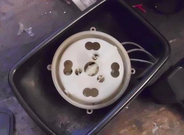

Be warned that the edges are sharp and you should sand them down a wee bit.
Remote adjust mirrors.
Carefully Pry the Mirror backing off the adjuster by levering off the Mirror Plate to the mount (there are 4 press fit locks on it.
Adjuster minus the mirror backing plate.
The mounting plate is affixed to the adjuster by 4 push click tabs, and a Generous bit of 2way sticky tape.
You can break off the old glass, remove the tape on the backing plate, and use new glass on it…

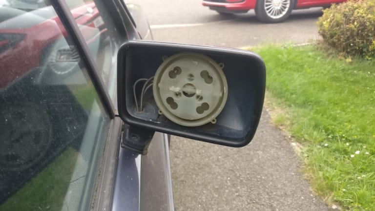

The issue I have is this:
The actual glass was lost (came off whilst driving) so don't have the original backing to use or a template to have a replacement.
As I said, ideally I'd like to try and get my hands on the glass backing (to help stop the above happening again) but I'd settle for just the glass, for now, to get it through its Mot.
