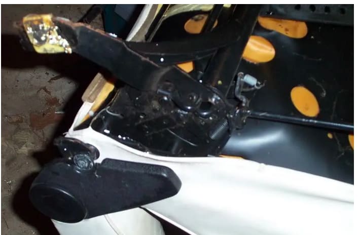

These are of my current seat
This is the 'new' scirocco base

That arm on the left is the Butt Adjuster, on the later Wolfsburg cabbies, and such both sides have them and the lever is on the bottom outside of the seat in the front.
