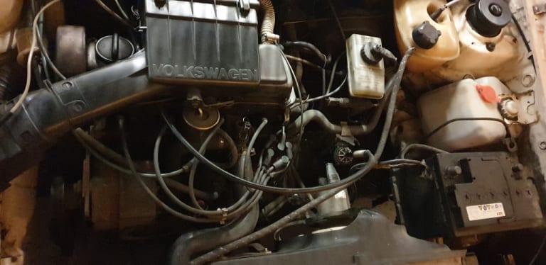

Cant see the engine code on the block, its pretty minging so likely covered up untill I degrease and clean the bay, can you tell the head off this photo?

It's possibly an EX engine.
Is that a common mod to for these? Confused as to which parts I can fit now 😅

So I found the engine code on the block and its an EW 02 … so its a standard block with a 1.8 head?
Now you understand the term "Frankenwagen" .
Muahahahahahahahahaha.
Post @'82/83 1600 and 1800 injection, carb, diesel had the same style of head. Althought used as an easy way to differentiate 1.6 and 1.8 GTI engines in MK1s that style head was used across all big block engines. Yours is a post '83 1.6 75bhp engine.
I think all UK Caddys were 1.6 D or 1.6 carb apart from the rare later 1.8 Sports
