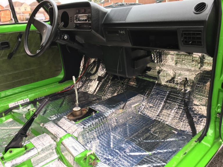

Got a bulk order of 4mm Silent COat from Amazon.
About £90 with more than enough to sort Yoda and it works a treat

Used the lead flashing stuff, it's good cos you can get it from your local building supplies place when you run out!
It works, yu might need two layers though on the floor etc. I have it in the Derby and in Clive
For Minx I've gone 'proper' 4mm silent coat as Mr Funk has used, topped off with Dodo mat. The I have some 5mm self adhesive closed cell foam to cover every surface (inc roof panel) over the top of eveything else.
Then the fluffy stuff, I'm going to get it from volvos in the scrap yard or other big estate cars, then the sand bags (they are in newer vag group stuff) followed by the carpet.
Hopefully I will still be able to get my feet under the dash!
I hate road noise!
