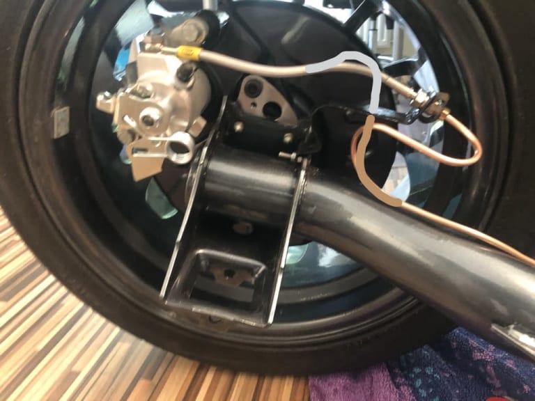

I am looking for thoughts on the brake line positioning
Thanks am using the flexi hose holders from the mk2 + mk4 callipers. The hoses I purchased ideally would have been a little shorter however I am where I am on that.

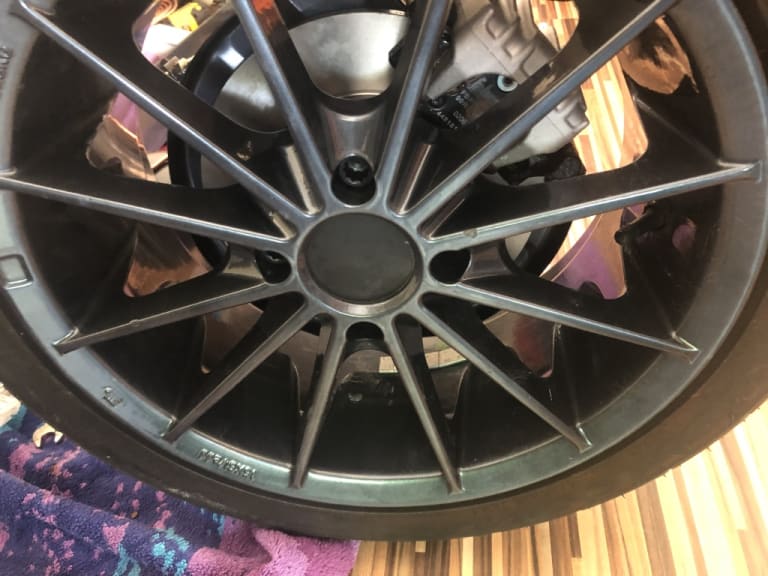

Have mounted the wheel on the axle to check clearances and it's ok but a little tight for the solid line.
This is where I need your input/experience - does it look alright to you guys or is it a bit sketchy by the wheel edge?
Just seeing if I am being too maverick or cautious here.
If anyone has a similar set up photos would be helpful.
Thanks Craig
I would also isolate the copper pipe from the axle by using rubber grommets split and slipped over the lines, or rubber strips and tie-wrap it to the axle with stainless steel wire-ties, as I know this is mocking up, but consideration of anti-rubbing and chattering should be considered to prevent the lines from repositioning themselves and or chaffing and eventually holeing themselves or work maring your pretty looking axle.
Lines are copper plated steel so I should be ok on that one - more luck than judgement though.
Thanks need copper slip is at the ready for when I do the tightening up.
Insulated to bracket with some fuel hose slipped over the line before making off the ends so nicely secured and my rear axle is electro powered coated so pretty well insulated for galvanic corrosion.
Stainless ties is a great shout and I shall invest in them.
Any thoughts on the route near the wheel? I think with the ties you suggest I will be happier with it as it will be more stable and not possibly move into an area where it can rub.
As you can see the gap is a finger size so ok but not exactly spacious.
Just looked at the wheel arch and may need to do it a little more direct. Also need to consider not stressing the union so the bends help with that.
Does any of that make sense?
J
It's spring steel so rock hard but should bend with a little heat.
Cheers for the input on it always the vision I needed. Will post once done. 👍

Personally, if I bought your car, one of the first things I would do is change out that flexi for a hard line.
Flexi's are necessary where there is axle movement for obvious reasons, but they are the weakest link, especially the braided ones, because you are unable to see any signs of perishing or cracking on those.
Rear disc conversion brake lines - input/opinion.
If you hard line it I don’t see how you can service the rear brakes
In that case, they’re a bit long, but good job!
