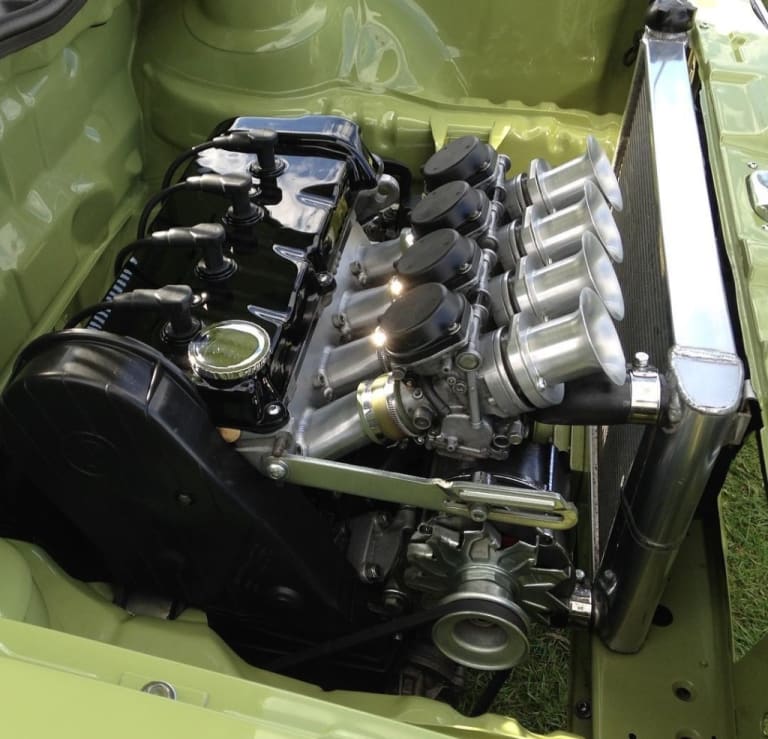

I just placed a deposit on a stunning mk1 golf which I'm set to pick up next weekend.
Fully restored, 1.8 Kr engine conversion with bike carbs, shaved engine bay, 15" bbs rs wheels and lots more.
I haven't owned a carbed engine before. I've been doing some reading and seen a few people saying they can be a pain to cold start sometimes and others saying they have no issues at all.
Is this true they are a pain or are they generally okay?
Any tips other than pumping the throttle a few times while turning over the engine. When I viewed the car the owner showed me he had a manual choke installed on the carbs themselves - I was paying attention however there was a lot to take in at the time!
I'm used to "turn the key and go" type of thing - this is my first classic car so lots to get used to.
Instant starting no matter the weather/outside temp/engine temp, instant smooth driving at all times and along with simple electronic ignition perfect in-tune running for 10,000s miles. No manually fiddling with knobs and cables to stop it stalling, bogging down or reving its kanckers off
All of which carbs struggled to do.
Now no one can be bother to maintain/repair injection systems (that are 40yrs and 200,000 miles old) and go back to the dawn of time and fit carbs…

Ahh okay I see. Interesting. This is all new to me as you can tell.
Yes it has R1 bike carbs
Regional Host NE
Injection gives you turn key and go, that's why it's the norm these days.
Your carb mod will be fine, it's just a matter of getting used to how much choke you need when cold starting, which will depend on exactly how cold it is, and also you will need to judge how much, if any , choke you need if you've done a stop and start - depends how cold it is and how long you've been stopped for..
Too much choke and the engine will get flooded with fuel and then won't start at all. The cure for that is no choke, full throttle and crank , this clears the excess fuel.
Not enough choke will prevent starting as well obviously, as not enough "extra" fuel for the cold start.
Once you get driving , say for example a cold morning, you will need to reduce the amount of choke as soon as possible as the engine warms up - this you will learn with practice - specific to your engine..
I'm showing my age now !!! Happy memories from when all cars had carbs, before the turn key and go era of today !!!

The weird thing with this is the choke is under the bonnet on the engine so I wouldn't be able to adjust it while driving (obviously) like the usual choke in the cabin
Purchase and pick up my mk1 - carbed engine.
Your first job, install a choke cable which can be operated from the driving seat !!!
