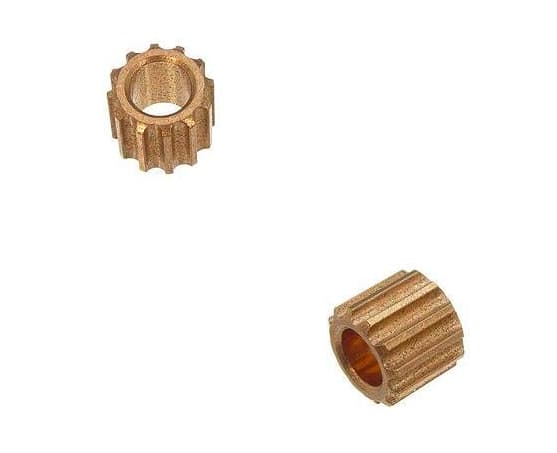

Tip, when ever I did a clutch, I replaced the release bearing, the clutch finger, as well as the bushing at the clutch end that the push rod goes through.
front bush
