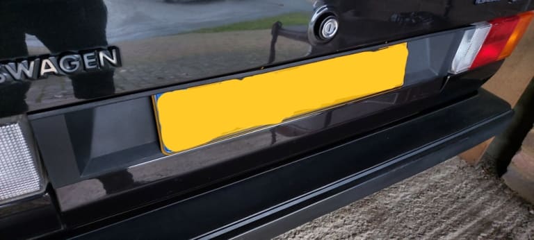

Hi All,
Does anyone know where I can find the clips to hold in the rear licence plate holder surround on my cab. It is causing it to be loose and rattle. Have looked on heritage and classic but not too sure what I am looking for exactly…many thanks!

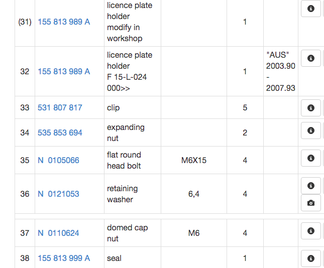

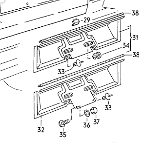

I think you are looking for 33
Thanks for your reply
Do you have any idea where to get these from? Thanks
Mk1 rear licence plate holder clips
Legend cheers

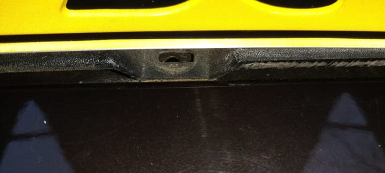

Also I have found at least on my US Cabriolet that I also used some 3M Weatherstrip tape, (double sided RED)
Little Squares on the bottom kept it from Flap Slapping when opening or closing the lid and on bumpy roads.

Do you know where I can get these clips (531-807-817)? The guy in Germany I found on eBay don't post to the UK now.
