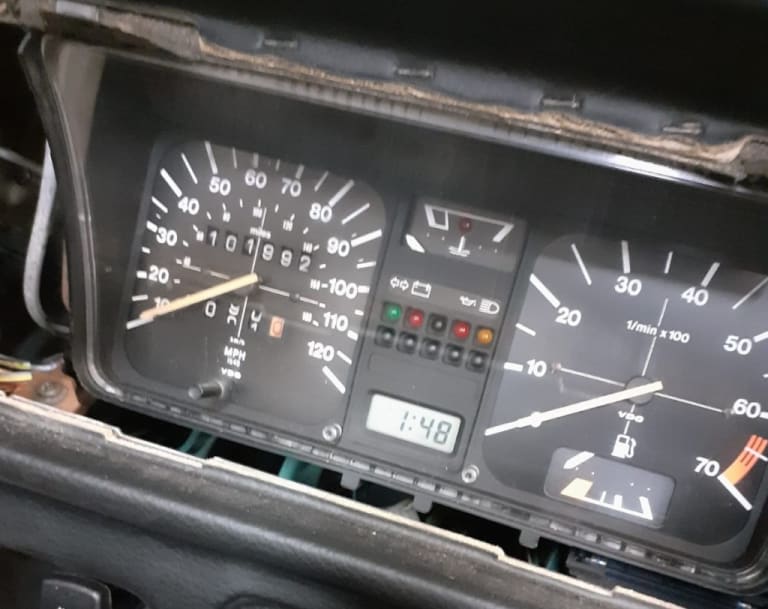

I made my first post yesterday in Intro section and had reply from Chortle, thank you Chortle but I thought I would upload some photos here as maybe this is more technical and other would look.

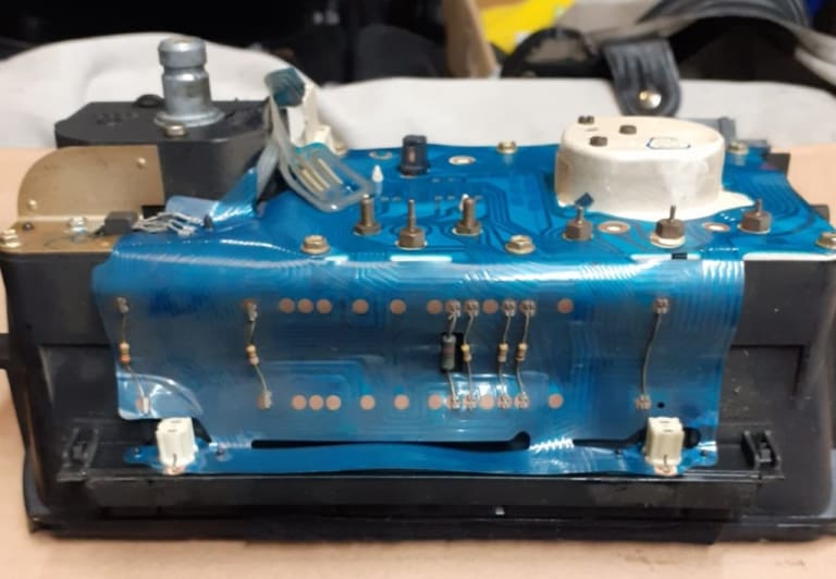

My problem is speedo dont work on Clipper binnacle so I got a Gti one and fitted that, speedo now works but fuel gauge rev counter and other bits dont work now.
I can see differences in circuit board and Chortle mentioned about Clipper not having MFA and thats why I'm having issues and to make 1 out of 2 which I'm looking into but could do with a guide or a walk through as I dont want to end up breaking both in process.
My MFA on Clipper is black screen what do you mean by mine not having one Chortle? has the Gti got more functions on it? these 2 binnacles look identical on front but different on rear.
Can anyone upload or link me to the wiring for both Clipper and Gti binnacle?
I'm new to all this so simple answers for me please lol
It might be easiest for you to just swap the speedos over. I note they are in different units though.

Auto electrical friend swapped over GTi speedo to original Clipper binnacle and repaired broken circuit board but I had no oil warning light.
The Clipper speedo has a circuit board within it that works the oil warning LED, so he done a bypass with a resistor and now all works fine.
