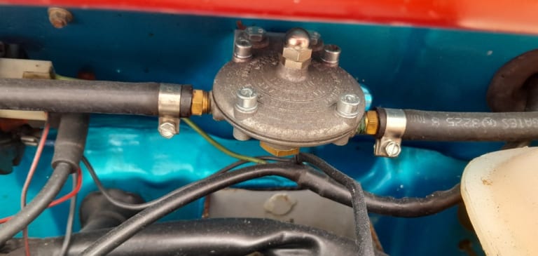

There's loads of help on here & most parts are quite easily sourced , as you know it's a great hobby but grows arms & legs. I'm sure it was advisable to fit an in line fuel pressure reducer when using the K jet supply 20250725_134103.jpg which I did.
Just double check all your dimensions & part numbers when ordering & good luck 👍
