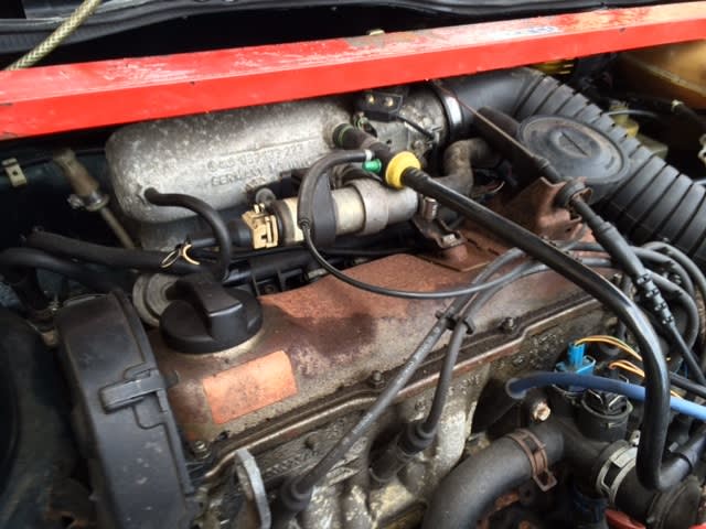

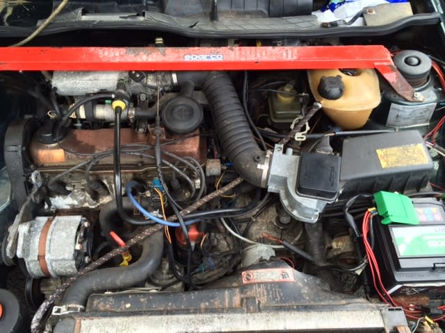

couple of pics
do you mean this connector, if you take the connector off once the engine is started it does stop the spluttering, but as soon as u connect it back on, the engine revs and then tries to cut out again.
is there a way of checking weather its working correctly ???
