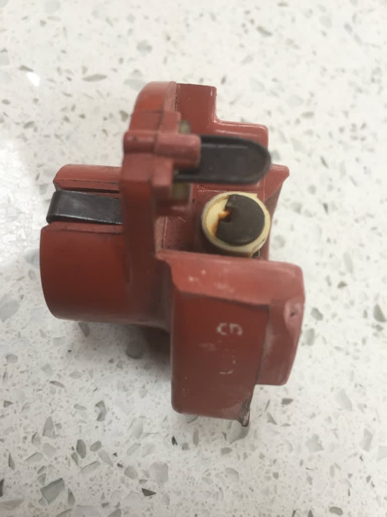

My rotor arm appears to be fouling the dizzy cap I got a new rotor arm today but it's still catching the dizzy.
Is this because it's a cheap one ?
Can I file it down where it's fouling?
I changed it due to the crack on the top
