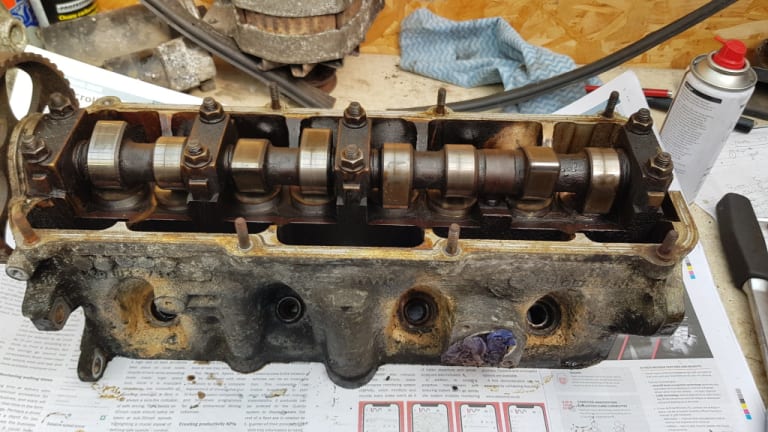

Info on tappets. Yours should be hydraulic as it was approximately 1984 when VW switched to hydraulic tappets, but you can see the difference and pictures in this thread.

I attach pics 1. The engine prior to stripdown 2. From today of the cam area. 3 the engine No
Looking at the link from mark1gls it seems I do have an 1.6 EZ with hydraulic tappets.
