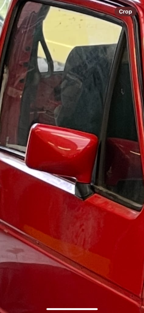

They are pressed into the windows and makes it really hard to wind them. Have tried spacing them out and swapping the bases over but just doesn't work.
You may have to take the door card off and inspect the way the routed the 3 cables for the mirror.
No interior in the car at the moment so it's not the handles!
I think the windows aren't sat on the guides correctly either
Follow that by using a soft brush and clean out the rubbers on both side of where the window slides up and down, once dry try it out.
I have done that on my cabriolets, (both electric) and the mechanisms worked more better.
