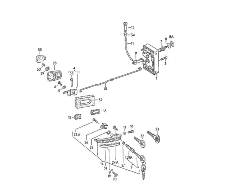

It could be that the white nylon lever isn't on the finger coming out of the latch. Number 9 in the parts breakdown.
