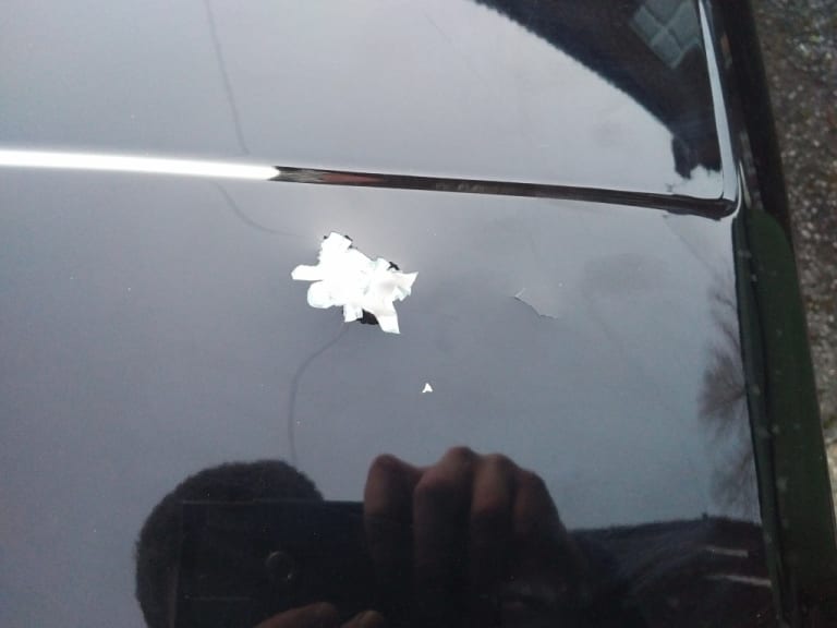

So today driving home, after the golf being off the road for 3 weeks with a few various issues…
A tinny rattling sound started at high revs, I thought it may have been some kind of heat shield.
Then boom, big bang, and the noise worsens.
It seems the alternator fins had been catching on the adjuster bracket, and it has snapped a fin off, straight into the underside of the bonnet…

Wow some force there. What's damage inside looking like?
On the drive

Ouch! How had the fins been catching? Were they bent or something? Hope you get it sorted soon buddy.
Not quite sure how they have been catching.
It doesn't look too bad inside, just 1 fin missing and the rest with wear marks on them, will investigate more tomorrow.

I have just booked in for paint, and the guy said the bonnet looks great and doesn't need any work…. It certainly does now!

So an update……
I took the bracket off and grinded it down slightly to give a little more clearance, which did stop the alternator fouling, i didn't realise but the alternator had been making a whining noise (only 3 yrs old).
When i looked at the alternator when it was being revved i could see the fan was moving away from the block, which was causing the fouling.
Needless to say, we now have a new alternator in hand, one of the last on the shelves like for like replacement, which we will be fitting tomorrow when the car comes out with its shiny new hood.
