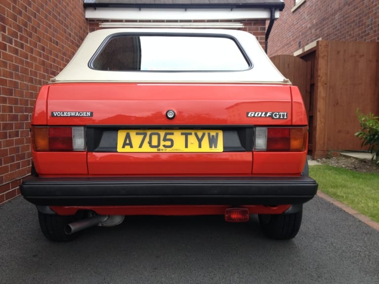

Does anyone have any reference as to which are the correct rear replacement badges? I have seen many 84 cabbys with the VW roundal badge and many that have the old style volkswagen badge and no roundal, with the older style GolfGTI badge.
But which is correct?
I have replaced the boot hatch so need to decide which way to go as I will need to fill and paint the existing holes as the boot lid is from an 87 mk1.

Here you go Warren. My boot lid was a newer version than the rest of the car as it too had the holes for the roundall. They were filled.
The roundall wasn't used on the '84 Cabby.
Link to the 1984 brochure, look at the bottom right image….
https://vwgolfmk1.org.uk/index.php?page=galleries&type=image&id=untitled_10164&wide=1&sort=url+ASC
Chairman
The Volkswagen badge was 20mm in from the LHS edge and 38mm up from the edge above the lights.
