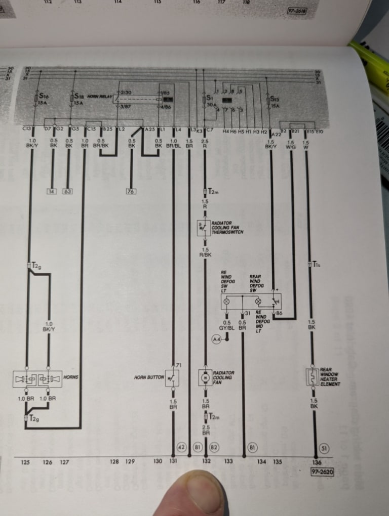

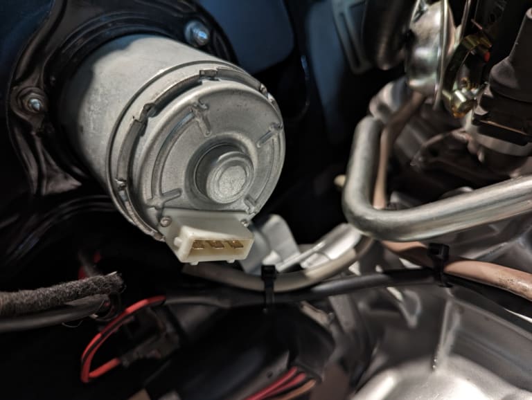

Here's what I have and some info. Turns out spectra made the radiator not the fan. Picture of the fan and purchased from autohausaz with their part number as well as manufacturer Vemo and their part number. Pic shows the temp switch in the radiator the 3 pin rear of the fan motor and the current track 132 from Bentley manual shows the temp switch and fan in the circuit.
Also from checking the circuit it might only be single speed……..I'm not sure about the speeds now looking back at this. Thought it was dual speed but now not sure. The three wires still makes me think it's dual speed and prob done with resistance as I mentioned previously.

Here's some more info. The two speed could be part of the after-run circuit. Think my car has the after-run circuit based on the wire colors.
Also attached is a copy of the after-run relay circuit for a scirocco, not sure if same for GTI if yours even has that installed. I guess mines doesn't have it installed. Current tracks 138,139 and 140

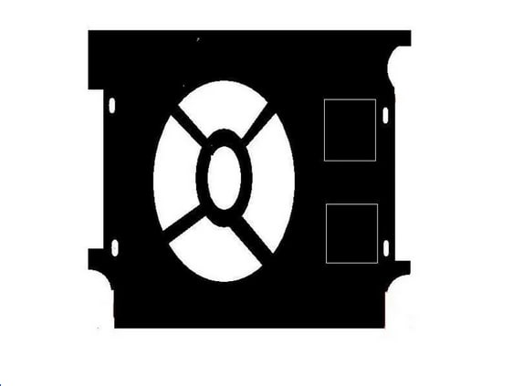

For those of us that remove the Radiator shroud, and have to fight the hoses and what-nots, I have come up with a slight mod that allows the easier removal of the thing.
The shroud looks like this:

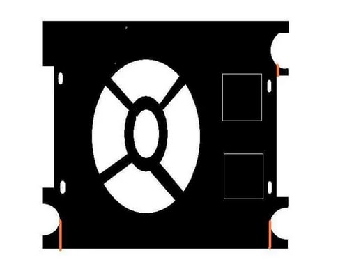

Here is the tin marked for the cuts.

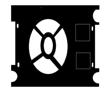

Here is the tin after the cuts.
It is a whole lot easier to get in and out.
