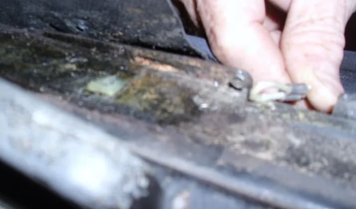

One side is locking correctly when the roof is down but the other side needs some adjustment or part replaced as it's showing sign of wear and the hook does not lock over the fixing to hold in place (it slips and roof doesnt stay locked in place).
You can see the wear on the silver part in photos any advice appreciated!
This is a picture of the locking mechanism…

What often happens is that the plastic spacers that space the frame components out and keep them steady often fall out because no one oils them.
They go dry and brittle then crack and fall out.
This then gives excess play and the once round holes go oval causing the frame to sit incorrectly.
That can cause issues of the frame not sitting down properly or moving forward enough to reach the header.
On the hood latch down you should oil the spring set up of the tab lever.
If the plastic washer has dropped out the frame that pin is on slips inwards and the pin doesn’t reach properly to lock.
You can either grind the back off the weld and tap the pin out and get some longer round bar and weld new length on or weld a small section to the end of the pin to make it longer.

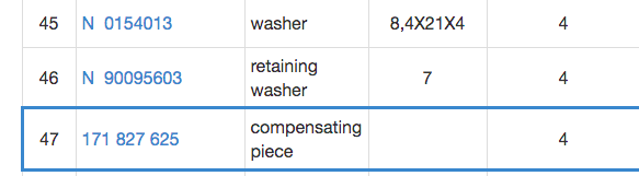

Compensating Piece.
There is also a large thick washer to be mindful of as it has a tendancy to fall off and keep you fingers on the lock clip as they tend to fall as well usually they end up behind the cardboard boot covers in the nooks and crannies… Still avail at most dealers over this side of the big lake.

I am also missing the rubber compensating piece for the bottom pin where the strut is secured in.

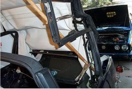

Open the top about half way, and safety it so it can close on you and smash your fingers.
I use 2 Vice grips and a length of broom stick.
On the rear frame in the middle you have to worm your arm between the headliner and the frame you will feel a hook (Look for the punch out on the rear frame face as that is where the hook is). Carefully pull the spring off the hook finger and out and the cable should come with it. You have to remove the cable of the side frame feed thru but it isn't that hard.
To re-run the new cable you will need a 3-4 foot piece of stiff wire ( the oldie coat hangers work, but you have to use only straight wire no curls or bends.)
You will also need about 6 foot of masons twine.
On the wire you will make a eye on one end and tie the masons twine to it tie the twine loose so the knot is about 1 inch behind the eye make it as small as you can you are going to have to get it as small as you can and then use some tape one or two raps around the hook to keep it from snagging as you are feeding it in. You can smash the eye flat with a hammer…then tape it.
You will feed your wire from the front of the top near the teat through the top and it will exit at the rear… you will pull this through so you have about 2 foot of twine at the front and at the rear then cut the twine off the feed wire.
Affix the spring and new cable then replace the spring and feed the cable through the eye on the frame to the twine. You will tie the twine to the other end of the cable. Slowly pull the new cable back through the top, then hook it over the front teat.
Take great care.
