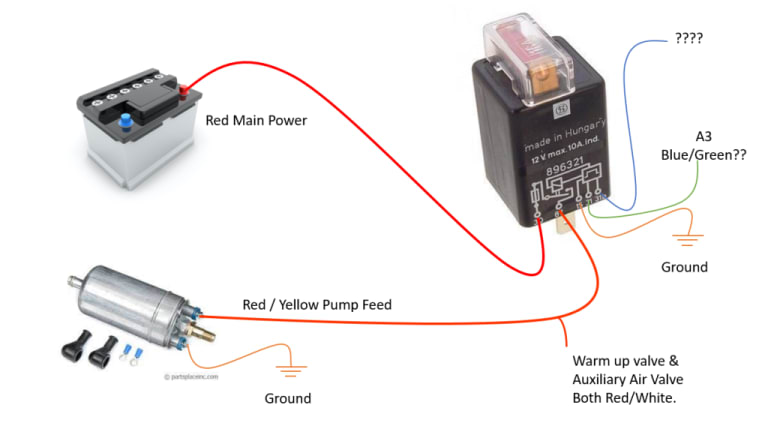

Will the attached image work if I cable it direct by cutting some wires and cabling the relay in using space connectors (cannot find a suitable relay holder at the moment)
Main power direct from the battery to relay terminal 30
Power out of the relay to fuel pump using terminal 87
Terminal 15 ground ??? Or is it 31????
Terminal 31 Blue Green from Pin A3 that feeds pin A5 (this may need to be terminal 15???)
Terminal 31b - No idea, some help please.
The cutting and bodging of my current wiring set up has led me to believe the fuse board is either done in on some internal tracks or I simply cannot recover it. Also pin A8 is showing signs of scorching so by bypassing all the wiring direct to the red/yellow feed of the fuel pump I remove this load.
Just need help on exactly what goes where on the 5 relay terminals.
