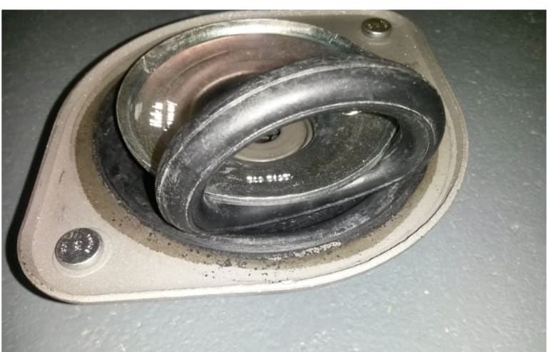

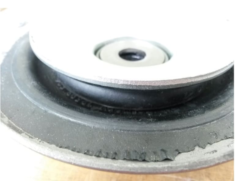

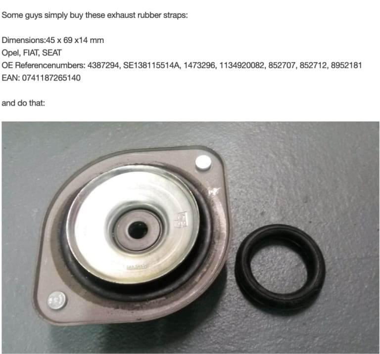

Over here there has been a lot of people using 3m Window Weld, and applying it to fill the GAP in the bottom of the mount.
They say longevity is increased and the ride doesn't suffer.
I haven't done it yet, but am getting ready to replace all 4 struts on the blue cabby and will consider "further beefing" the mounts.

Thanks to 81MarsRed of the VWvortex for pictures of the Opel mount trick.
