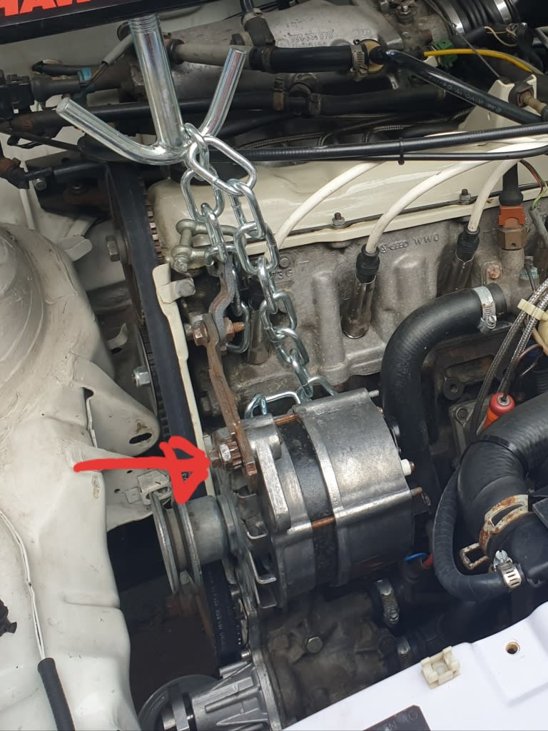

It should drop enough on the adjuster for you to slip the below off with ease - you got a photo of what part you mean? There are a few ways to get that rounded bolt off bit depends where it is.
I just loosen off the adjuster bolt to drop the alternator.

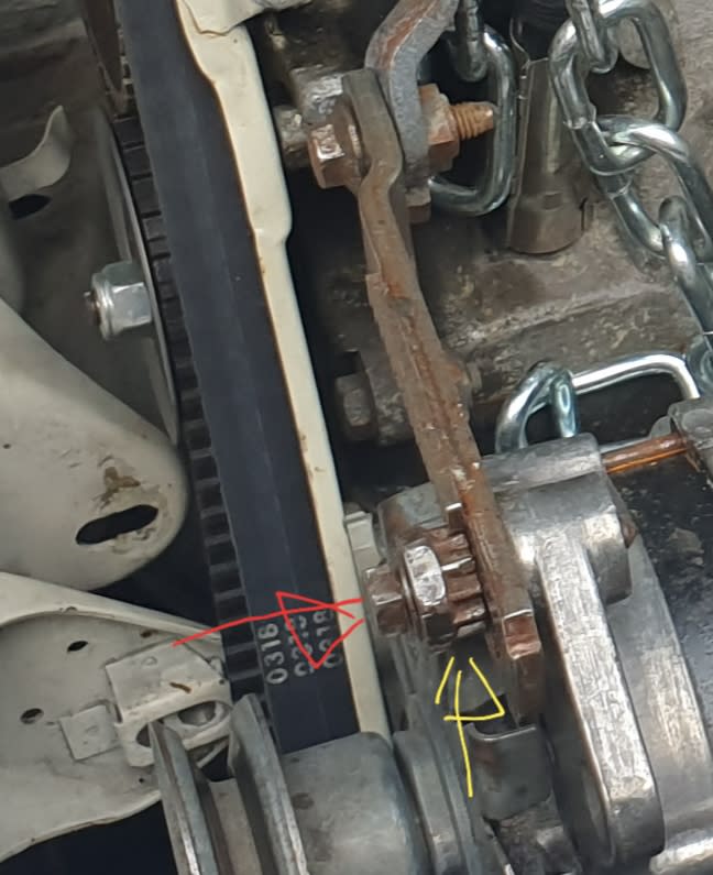

Thanks for the reply. I've loosened the adjuster bolt you've highlighted but there was no movement in the alternator at all (I've highlighted this bolt on my photo below in red). I didn't want to force it but I suppose I could try again in the morning and try a bit harder

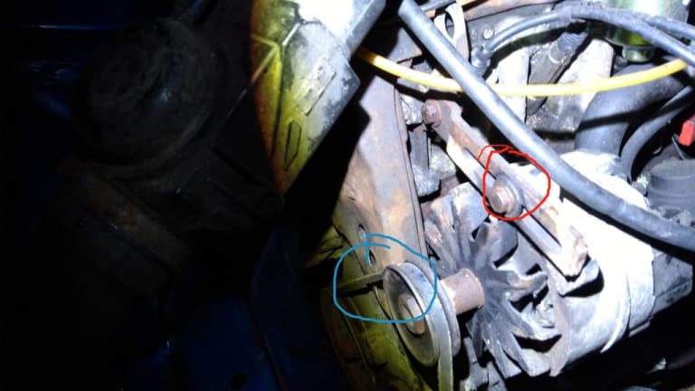

The bolt I'm having the issue with is hard to access and will be a pain to drill out (I've highlighted it in blue). You remove a plastic bung and access it through a hole in the cam cover. 6mm allen bolt but unfortunately rounded off
Sorry, it's dark and wet out so not a good pic, plus my engine bay is not as clean as yours!
If your alternator pinch bolt IIRC 5.5 or 6mm Allen at the bottom is tight it won't move, and will have to be loosened so the alternator can swing freely.
20191109_213857.jpg Right, the pivot bolt at the bottom - if you have rounded it that's going to be a right 5h1t show to get out!
To lower it you only need that bottom one slightly loose, you don't need to take it out - I don't even touch mine when messing with the belts I just use the nut in the photo - that's what actually let's it move.
Did you try both bolts/nuts? The small one (red arrow)  loosens then you wind the big one (yellow) to move it - like a rack and pinion  - it might be quite stiff at the bottom pivot point where that big hex bolt goes  - so soak the pivot point in WD40, give it a while and then have a few gentle taps on the alternator with a mallet while trying to loosen the larger nut - if you are lucky it might break free a little and allow you to lower enough to slip it off.
If you have to get that bolt out (don't try if you don't need to) this is what I would try first.
Soak the hex bolt in something like WD40 or GT85 etc -its pretty long to get the other side as well and make sure you have the right size hex in there.
When you put it in next, hammer it home with a hammer to make sure it's seated in well then gently apply pressure.
If that's not working then you could try a stubby screw extractor on a socket wrench - the kind that has the short reverse threads and cross your fingers it bites https://rover.ebay.com/rover/0/0/0?mpre=https%3A%2F%2Fwww.ebay.co.uk%2Fulk%2Fitm%2F233347494988
You could also use a length of wood or similar, through the car and use it to apply force on the socket to act as a leaver to really push it into the head of the hex as you ratchet gently.
I am not sure how much plastic is there - I think you might melt your main belt or cover but if you can get the engine warm then blast the nut with a blow torch to heat it as well that will help as a almost final resort.
If you still have no luck with that then due to where it is the only thing I can think is you would need to get the engine out, although someone else may have a better solution.

Later cars had the (MK2 Golf?) style toothed adjuster, it is very useful in tensioning the belt compared to the earlier single bolt affair (you've highlighted with a red circle) With the single bolt you need to lever or pull he alternator up, but then you need another pair of hands to nip up the bolt….
The Allen headed bolt is the pivot and the single bolt (highlighted) and the bolt holding the adjuster 'bar' to the block are the ones that maintain the belt tension.
Sooooo slacken the two bolts holding the tension and gently (!) try and swing the alternator up and down on the pivot. If this fails I'd remove the cam cover to give abit more room and vision and try and hammer in a larger Allen key or a hi-hex star. You could replace with a standard bolt or source the correct VW (will be maga £… for what it is) Allen bolt. Good luck.

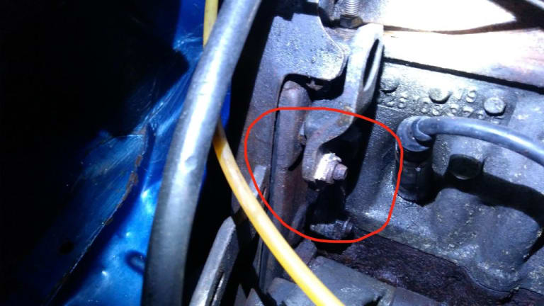

Well, I finally managed to go out onto the drive last night (the weather here has been shocking) and have good news and bad news.
Good news - after loosening the adjuster bolts I was able to lower the alternator forwards and downwards enough to remove the old belt and fit a new one. It needed several gentle taps with a rubber mallet to get it there, so I'm hoping the tightness of it will help when getting the tension right (I hear it's a 3 hand job)
Bad news - the adjuster bolt connected to the bracket was seized solid, and finally snapped when attempting to loosen it off. So although the head of the bolt is off, the square nut on the other side is still in place. I've tried to shock the nut off with a hammer and punch but it doesn't want to go anywhere - the bright area is where I have been attacking it trying to get the bl00dy thing off!
I assume that these square nuts are not welded onto the bracket so will need to think of another way to get it off. A grinder is probably the easiest way if I've got the space, but as you can see from the pic below, a couple of fuel lines are nearby which is making me nervous…

I know now me and you have different engines but on my DX block those square "Nuts" are welded onto the hanger/alternator bracket  - that's why it's not budging.
those are not, or should not be fuel lines in that photo - or in that area at all I don't think, in that photo, it looks like you have a yellow vacuum line that should come from your intake? - but i am not sure as it looks quite thick, - if that is your fuel line i am pretty sure that should be behind the engine and up the firewall not that way around the engine? - someone else will know better because i only know the layout on the GTI/DX engine
you still have a bit of the bolt hanging out - try backing it out from behind instead - get a firm grip on it with some new mole grips (new so they have super sharp teeth to bite) - obviously soak it in penetrating oil first.
if that's not working move all the plastic away and blast that bolt with a high-heat torch - if you have one - use a MAP-Gas torch to heat it up as the engine will sink the heat away from those small hobby torches, if not then just use whatever you have to hand

Well it certainly wasn't budging, so it could very well have been welded on! Nothing a angle grinder couldn't fix though!
I managed to get the nut off quite easily with a nicely worn-down cutting disc I had, so job done! I've replaced with a standard nut & bolt, with a good splodge of copper grease! Belt tensioned back up and no more squealing coming from the engine. I seem to be getting 13 volts at the battery when the engine is running, so the alternator is still working !
