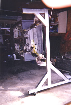

I was going to make one like this:
But yours looks a little bit easier to tip over, but I need some wheels on it so I can get the car to the sandblaster.
When the car is tipped over, how high is it over the ground?
The higher you make it, the more unstable and harder to roll it becomes.
Wheels would be doable - I think one of the guys on the caddy forum that has made from my plans has fitted wheels.
