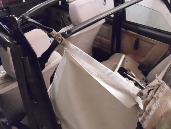

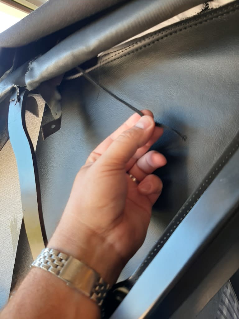

These are the only straps that I know of to attach the sides of the headliner to the frame. They don't go tot he "c" pillar at all.
One Vinyl strap is inserted in to the headliner, and affixed to the rubber band that attaches to the frame, the other end of the strap is attached to the rear window frame bow.
What happens is that when the pivots on the rear window frame and bow are all oiled and free to move.
Opening the top the Rubber Band at the front is under tension with the top closed so that when you open it acts as a spring and pulls the rear window bow up at the top and in to position as the vinyl strap is basically snapped in to place. When you close it the vinyl strap relaxes and the window is allowed to fall under its own weight first to rest on the parcel shelf. The weight of the rear window frame places tension on the Rubber to stretch and pre-load the frame.

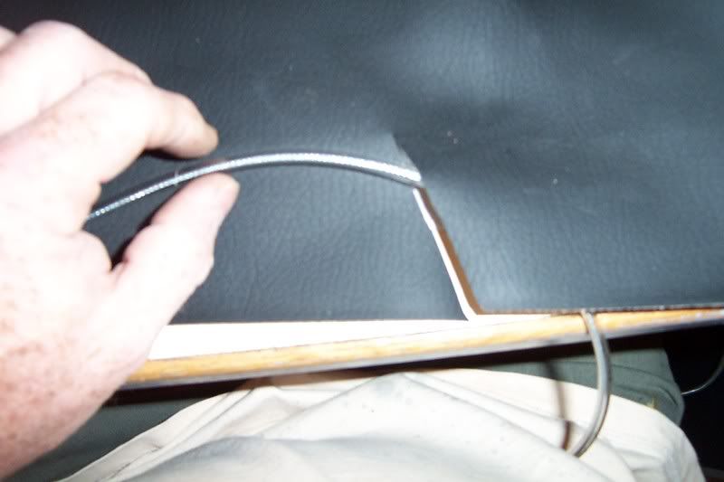

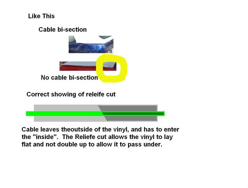

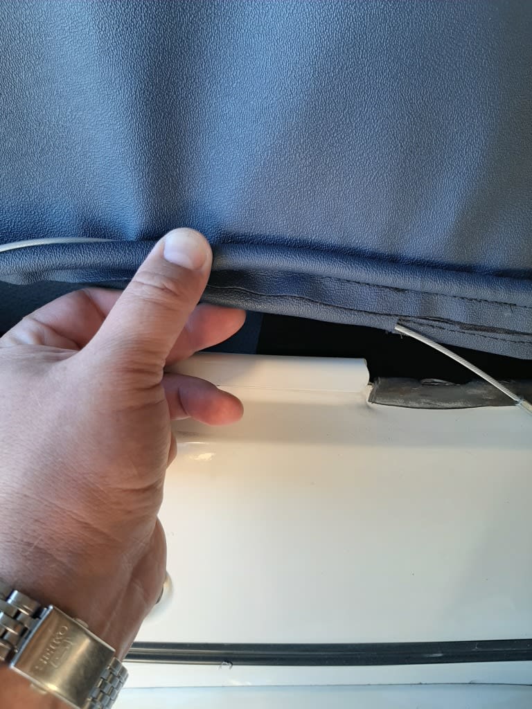

Now on to the relief cut.
Caveats, if you have trimmed all the extra material from the construction of the top, then chances are that you don't need to make it.
If you didn't trim all the extra stuff, then the relief cut or hole allows the rear cable to enter from the outside to the inside of the cabin or from the cable tray to the interior of the car with out bunching up the extra material.
For example, the Cable has to leave the outside of the top and enter the cabin, if you don't have a relief cut, or didn't trim the material then you have the cable folding over the material and bunching it up.

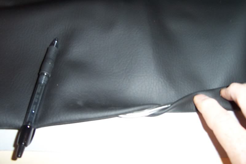

These are examples on scrap material not a real top.
If you make the relied cut then the cable cleanly enters the cabin and doesn't fold over the material preventing a bunch up.
Hope this helps…. to see what the difference is in the way it looks and appears.

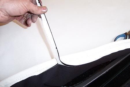

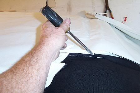

Trimming all the excess material off the top getting it as close to the stitching as you can without cutting the stitching.
Showing the relief cut after trimming the excess at the point of the cable entering the interior from the exterior.

They go from the corner eye to a strap riveted the the frame.
On early models they go from one of the plastic nut covers to the rear corner eye.
chortle said
Those elastics are factory installed.
Never seen them over here on this side of the pond… would love to see a picture of it…and is it to keep the headliner side taught?
