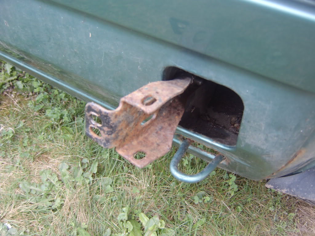

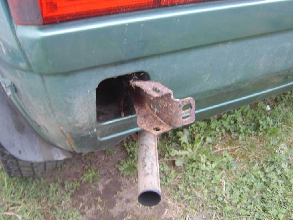

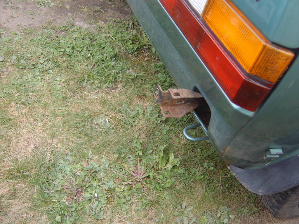

i like the look of no bumper effect on mk1 golfs (well until i save up for a chrome one) so i started to remove it at got the bumper part off fine but then it came to taking off the mounts. the nut have gone soft and i have now rounded them  :banghead:
could anyone advise on how i should take them off. all help appreciated. :)
cheers
vw golf mk1 GX 1.5 1983
open the boot.
look just above the floor on either side.
2 heads each side.
remove them.
you dont have to remove the bumper irn you take it out in one go.
I used mole rips. they clamp on nut head. U should get replacements at B&Q
can i ask are you putting a spanner though the hole in the rear valance?
cheers guys. novo you must work at vw or had loads of golf mk1's.

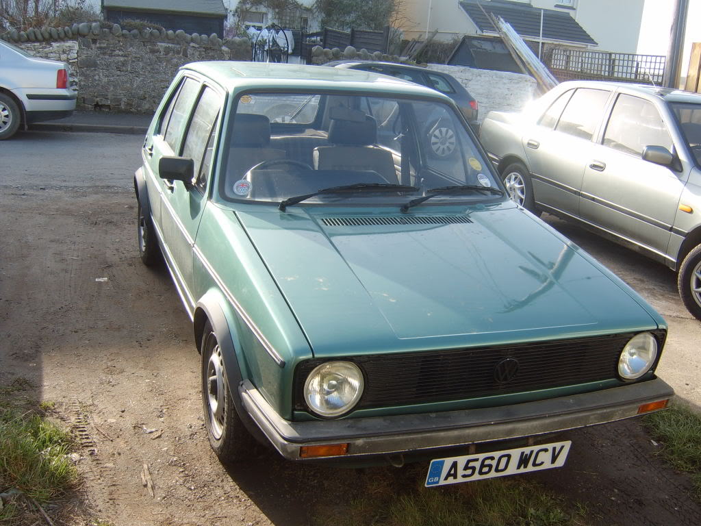

is it difficult to attach the front indicator lights onto the body when i remove the front bumper? do i need to wield them or anything hard.
cheers
no mate. i own 1 golf. and i work no where near a dealers.
front indicators you will have to make a bracket for.
do you know what type of indicators you are going for?
you shouldn't need to weld anything though.
was just going to attach the original indicators on to the body. these.
cheers
theres no where to fit them other than the bumper mate.
you need to either get side repeaters like this
which is lawsys old gti. or mini front indicators
which is hiluxs motor
have a look though this thread for ideas.
http://www.vwgolfmk1.org.uk/modules.php?name=Forums&file=viewtopic&t=47530&postdays=0&postorder=asc&highlight=gulf&start=10
its a bigger job than i thought. is there really no way of using the original indicators? tho the mini indicators do look quite good.
cheers
Fitting different indicators isn't that complicated. You could always cable-tie the originals to the bodywork somewhere, as Lawsy has done before. Otherwise you'll have to use a little more ingenuity to fit different ones.
