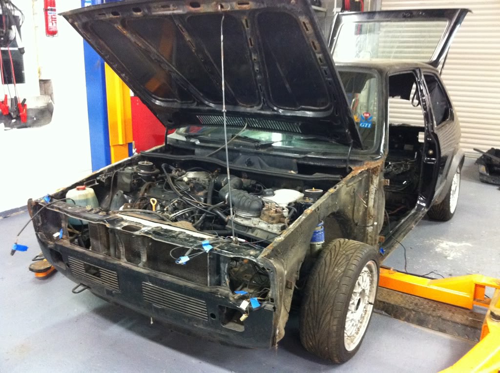

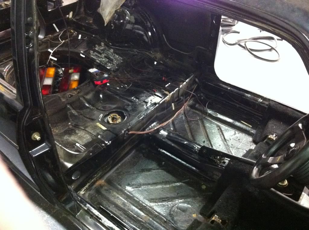

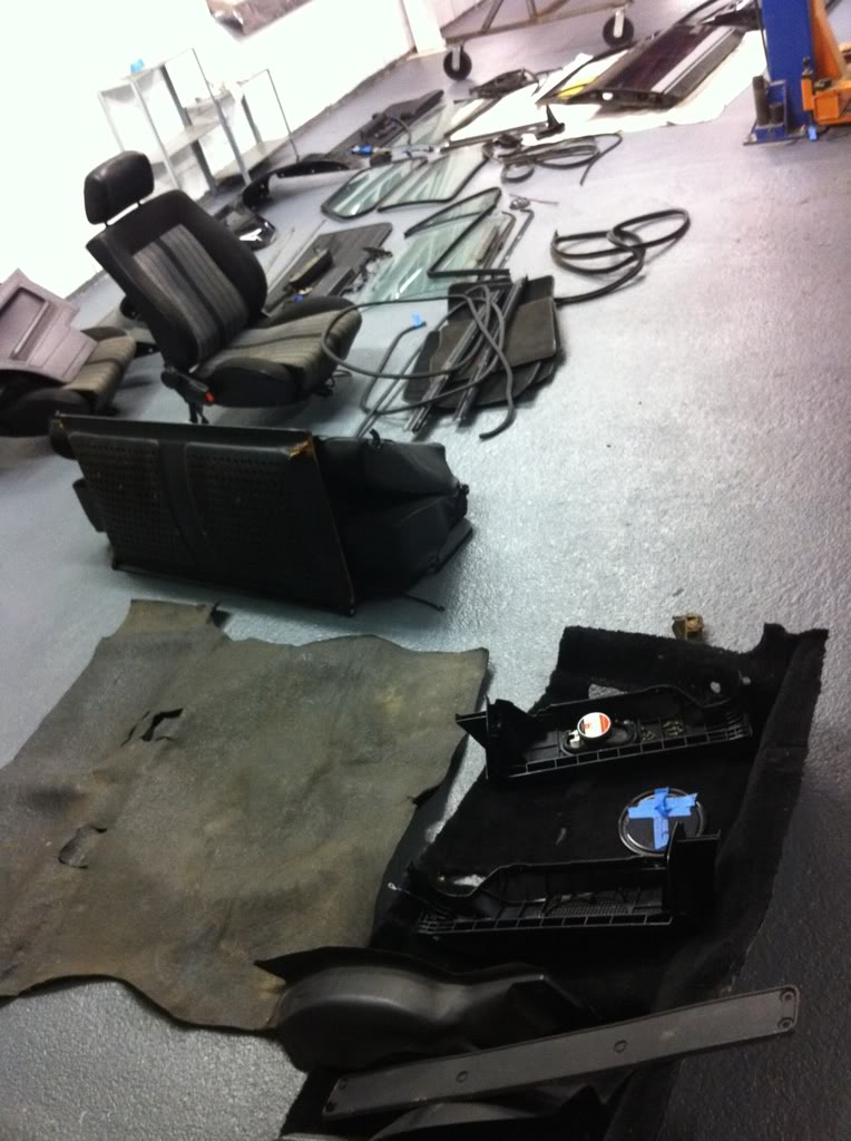

Some pics. I'll do a project tread in a while. Phone pics but ok enough.
