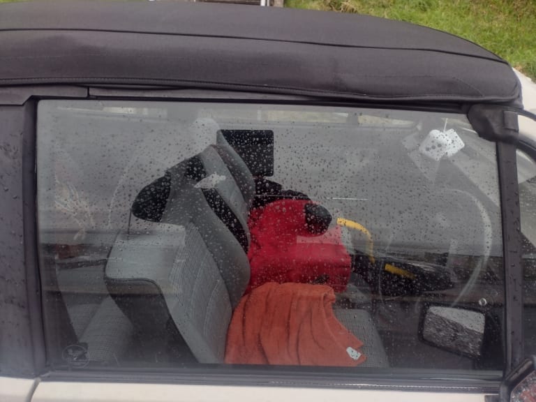

Just got my hands on a clean '81 Cabby. Got a few little jobs on it till im happy (for a while!!)
The main thing im trying to sort is the alignment on the passenger front window. When its fully up and you shut the door it seems to leave a slight gap to the hood, not by much just 3/4mm. Is there anyway to adjust the angle?? Had a gander through a Haynes but nothing on adjustment as such……
Right along the second fold in the roof it seems to bow upwards slighly which does widen the gap anyhow but it sits flush on the drivers side?!!
Cheers in advance!!

Ross, when the window is wound up it does touch the rubber of the hood at the front but then as far as you go towards the back of the door it gets wider (max about 3/4mm) I had the door cards off last night and had a look at the widen mech and this seems fine. Im guessing its def the hood thats the prob, but at first doubted it because the drivers door glass sits straight at the top.
I think from what you guys say its proberly just bowing on the passenger side of the hood more :dontknow:
I will have a look at the eccentric bolt and cables youve mentioned tonight.
Cheers again peeps!

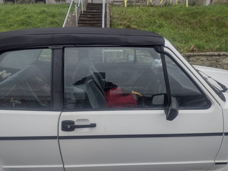

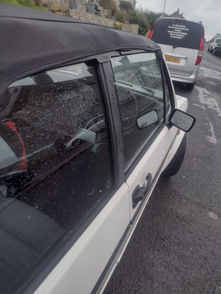

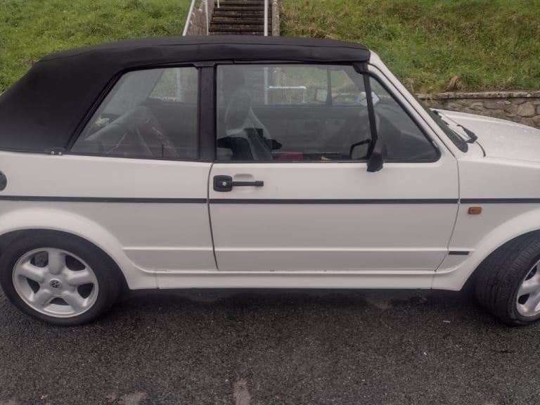

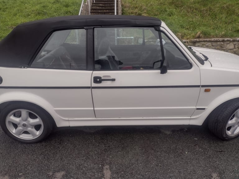

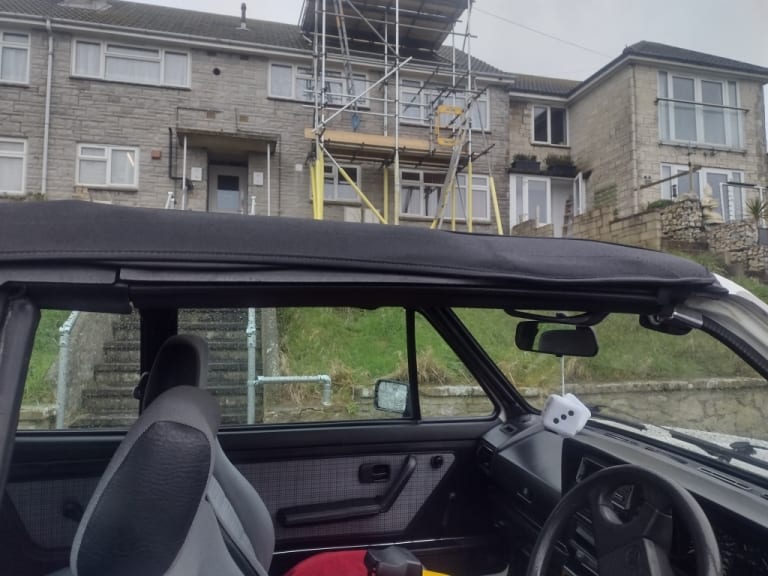

I need to see more pictures, as in:
Side of the car to include the door and the body.
I need better pictures of the the door class at the top as in the whole door and glass.
I need to see the way the top seal at the a frame.
Quick guess is the glass needs to be adjusted and the window stop on the regulator need to be reset and adjusted.
That is all bets are off if the door is sagging on the hinges and that is why better pictures are needed

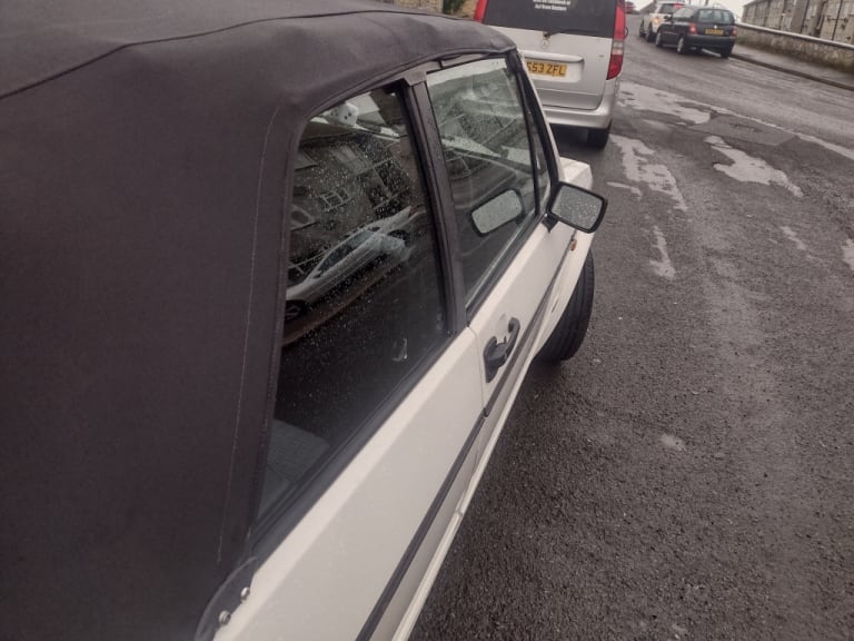

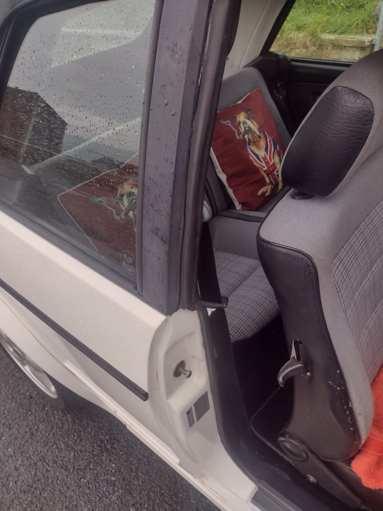

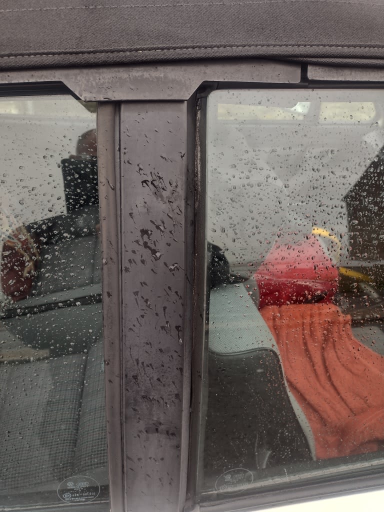

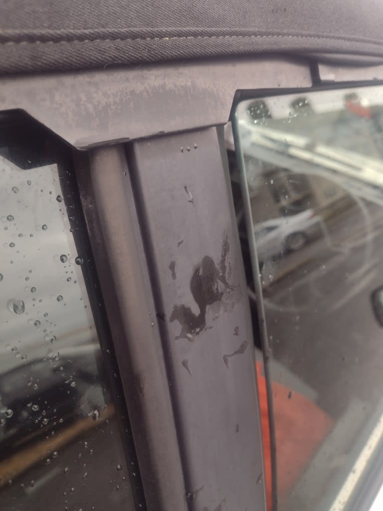

I see a few areas of issues, but would also like to see pictures of the door with the glass halfway down, as well as where the a pillar meets the door vent with the door closed.
The Cables on the sides are either either stretched or broken. They attach 2 different ways and the replacements are based on a prey 83 frame or that latter frame. I would need to see the top fully opened to guess. But I have a thread on the side cables in the archive. The newer top sits lower on the chassis when folded than the pre 83. They attach at 2 different places one set (the early frames) are longer than the newer style.
Your car door may be sagging a wee bit and folks adjusted the glass for the mal positioned door.
Why, because your door lines aren't correct.
Your front edge of the door is not gapped it is too close to the front fender.
Your tops eccentric looks to be off as well as your B Pillar seal looks like it is being compressed by the top frame.

The in and out bow of the window glass is controlled by 2 10mm bolts at the bottom edge of the door at the rear.
does it have electric windows or manual. The Bottom rear adjusts the window to bow inward or out. but all screws or bolts on the regulator are one adjustment or the other.
