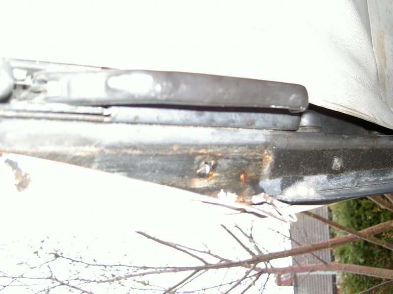

Found it……A is spring locations on the Clipper, B is the GTI

Before
Anyway - here is what i did:
Remove rubber seal from front side of roof, remove seal fron rear side of roof.
Remove the seal holders (4 screws each)
Carefully prise out the plastic screw plugs
Peal back hood material
Remove spring
pull broken cabel out
Feed a length of brake pipe through cable run
Attach new cable and pull through
Attach cable at front
Attach to spring at rear and hook up spring
Put it all back together
Job done

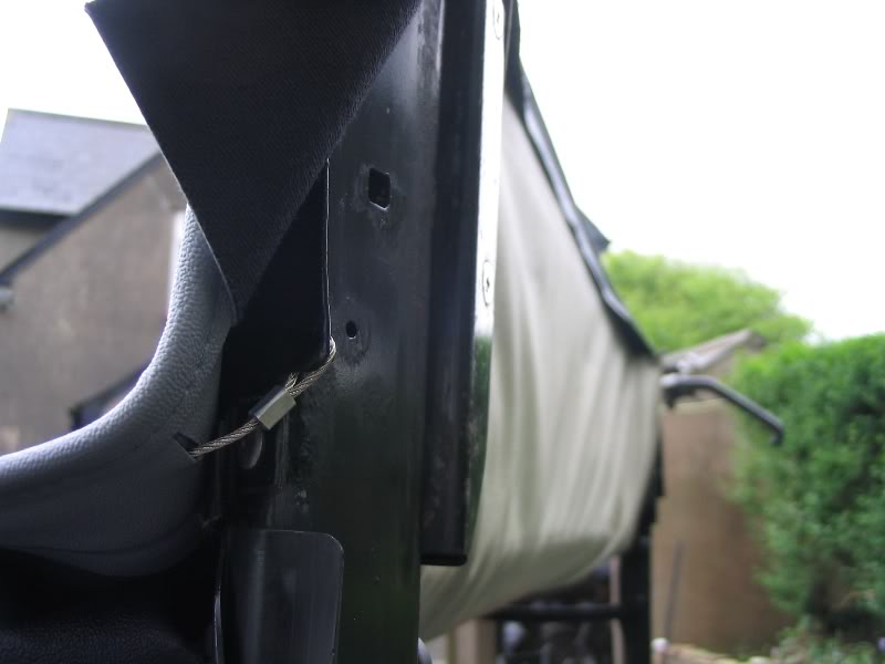

I have found the springs at the back, and the broken cables running through the channels at the side, but I am not sure what I'm looking for for where they attach at the front. Any ideas?
The cable runs through the side of the hood and appears out of a hole just behind the front side flap of hood fabric that gets glued to the frame. Hopefully you can see in this pic what I mean…

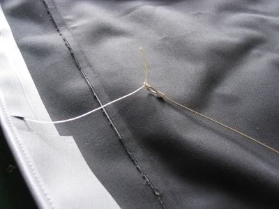

If you can see both ends of the old cable join the new and old cable together securely with a tough bit of cord so you can pull the new cable through the hood…
