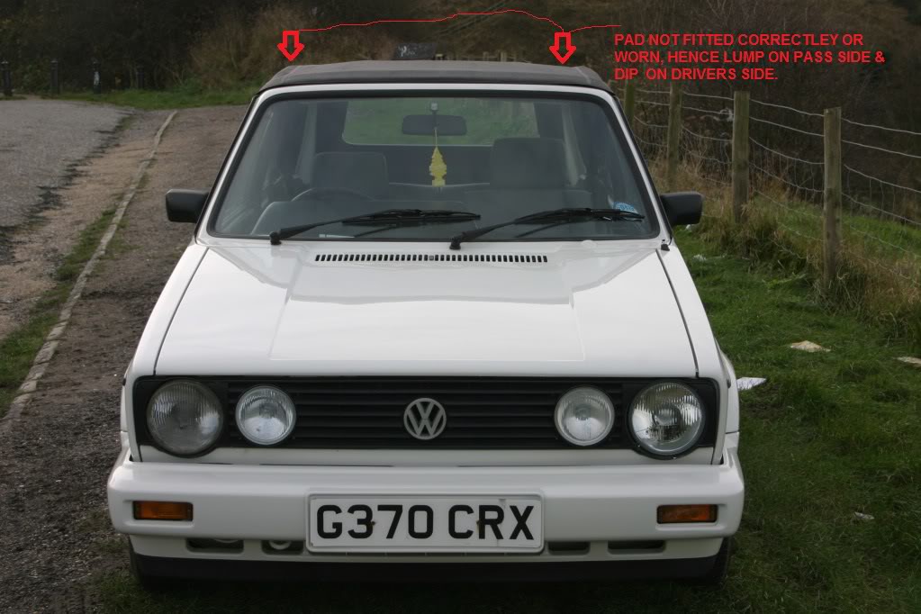

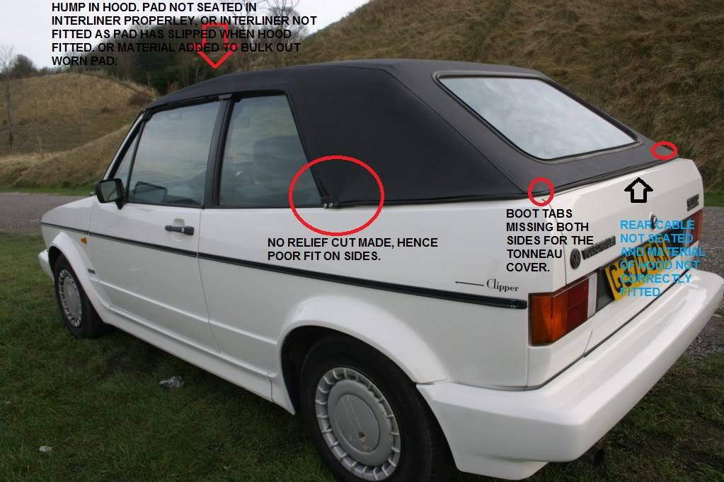

Unfortunately it's been poorly fitted, I would ask for the money back and have a go yourself.
Apart from the corner roof issue as you mention.
Your Mechanic has left the boot tabs off so you have nothing to attatch a tonneua cover to. These would of been put on prior to fitting the cable in the entry slots on the hood.
He has not aligned the roof properly at the rear so this will throw the hood out. The rear cable is not fitted correctly nor the hood material drifted in properly. This will need redoing, it may involve taking the rear window out to re tension the material in that area as its rippled.
The area around the boot snaps are rippled and out of shape, due to the relief cut not being made, before fitting.
You have dips and humps in the roof too, this really should not be a problem if a new interliner has been fitted as this holds the pad in place whilst you fit the hood, either that or the top pad is worn and he has added stuff to bulk it out, thats why I reccomend a new one.

Bit concerning as you say he has experience in hood fitting on MK1s and yes the boot tabs come with the new hoods, so they are lost somewhere then.

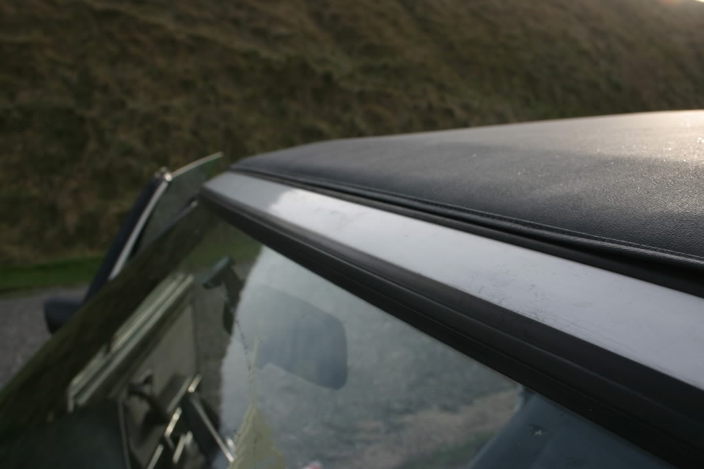

Also, a small amount of rain has been getting in on to the parcel shelf. It looks as though it is seeping in through the bolt heads which secure the window frame (if you look from inside the car back toward the window frame, bottom of window frame each side. Please help again!!

1) did your fitter redo the sillicone around the front screw hole on the front side metal seal retainers?
2) did they renew the mastic under the front header seal?
3) did they use the correct thickness foam gaskets?
4) have you a good seal between the drivers windows and the rubbers?
5) did the fitter reseal the rear window before and after it was fitted?
6) was sillicone applied inside the hood seam across the front before being put on?
any info you have on how and what he did will help.
