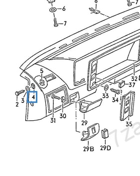

Question though - what size bolts are the 2 on either side of the dash (the ones that needed the 8mm socket)
Just bought my cabby and the dash is loose, no bolts in the ends

From the etka: Screen Shot 2022-11-03 at 11.54.47 AM.png
You will also need 2, 3, and 4.
Number 4 is the Cupped plastic washer that the bolt fits in.
