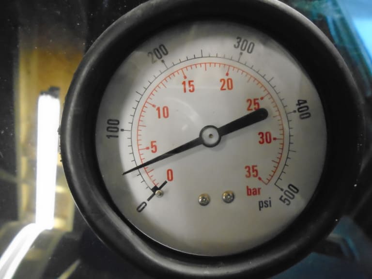

Still trying to get to the bottom of my oil pressure light problem. I connected a pressure gauge today to the hole on the cylinder head. Do these pressures seem OK ?
The first is cold at tickover
The second 80C at 2000rpm
Thanks !

Your pic of the guage at 2k shows a lower psi than I would have thought it should have for those revs. When you say the 'engine didn't sound happy' I wonder if the shortage of oil was seeing the shells pick up?

So I would suspect that you are fine.
MOTY 2013
in the cylinder head you need to have at the very least 0.3 bar when idling, otherwise the warning light will trigger. if the pressure is too low at the head vs what you see at the oil filter housing this can be down to worn camshaft bearing caps or some kind of issue with oil flow to the head.
at the filter housing when cold the oil pressure will go over 5 bar, then drop to around 1 bar as oil warms up to temp. at revs you want to see the pressure ramp up, at a bare minimum warmed up you need over 1.8 bar at revs otherwise the light+buzzer will trigger
