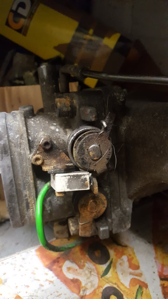

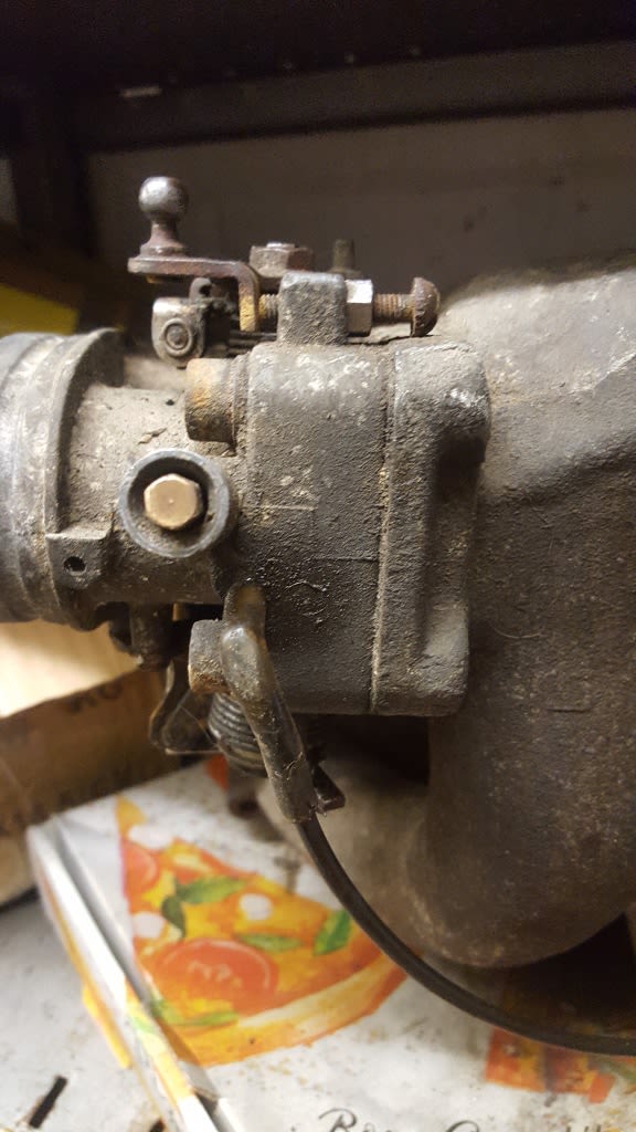

Thing is this one seems to be on the exact spot as the idle screw on the original on my engine…
Any advice is welcome!!!

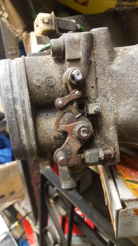

Re:
Hi Paul, thx for the better pictures! Unfortunately this shows to me what I already was frightened of. Where you have an idle screw, is also where i have one on my original tb, but not on the new one…nicci21paul said
need any more mate
Anybody any experience with this problem? Can I drill one myself?

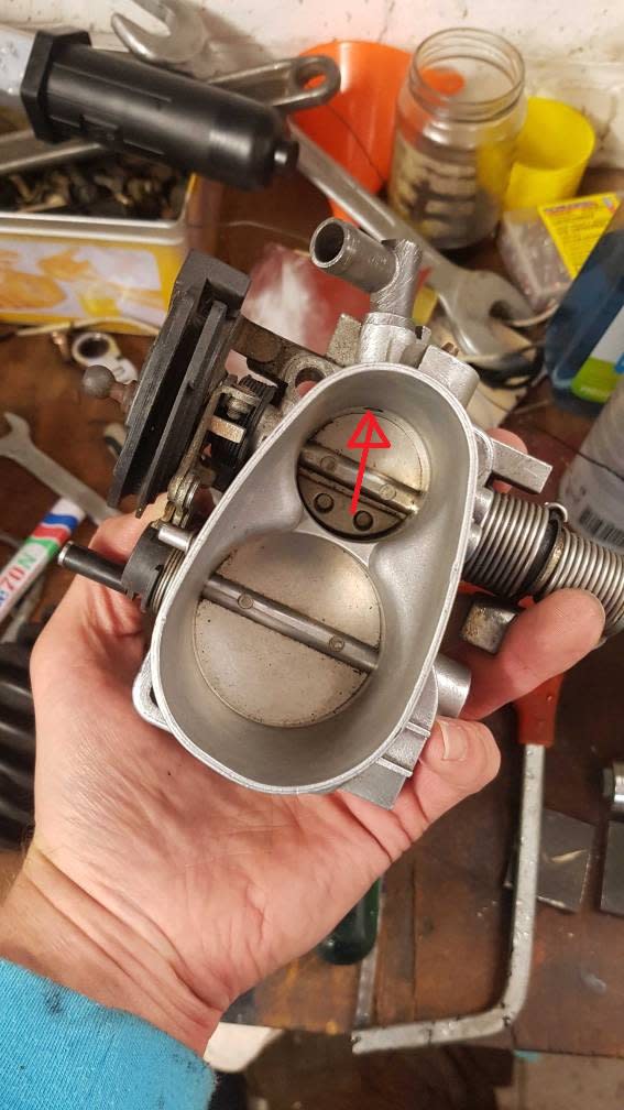

I think you would struggle to make your own idle screw inlet as it is tapered to fit the screw.
If it was off ebay, I'd double check the listing - you might be able to get a refund. Sorry I don't have better news!

Having just dug mine out of the box it's been living in for god knows how long, it's the same as nicci21paul has pictured. I don't know what Audi your is off, but it's not the right one.

Sharp eye!!sporttrucker said
it looks like the hole for the idle screw is in the audi body by the smaller butterfly and looks like it points to the large vac pipe connector so might be drilled for the screw if you remove the pipe fitting![]()
Had been thinking that too, so tried yesterday to carefully pry it out, but no success.
I've contacted the seller to check whether he wants to take it back (but no high hopes here).
If he doesn't, I'll take the heavier tools to remove it, keep you posted!
