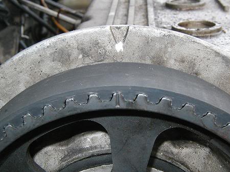

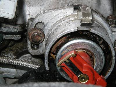

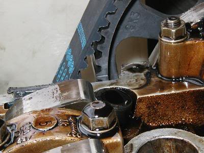

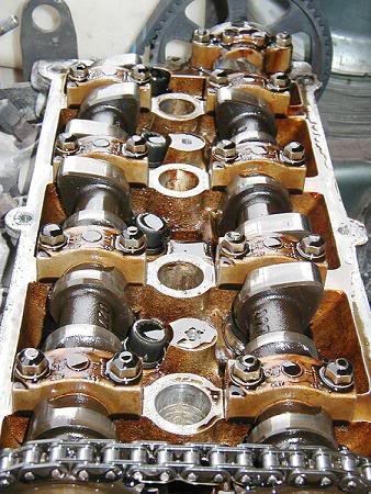

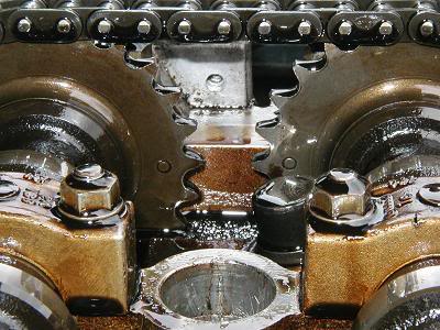

The car isn't running very well, the engine was running fine when removed from the passat, but since i have changed the cambelt and also the cams for kr ones, i have also used a scirocco inlet manifold with injectors/lines etc. The timing is, i think spot on, here are some pics….
the bottom end has been timed up to the mark on the pulley/lower cam belt cover which also lines up with the dot on the flywheel.

Is the new cam a high lift one? This will cause the idle to be lumpy.

Leads, cap, rotor arm etc are all good, forgive my ignorance but how can i check the ignition advance as it should be controlled by the ecu?
