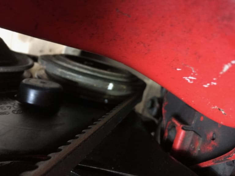

I painted mine white when I rebuilt my engine so they are easier to see.
There is also a mark on the dissy, If you remove the cap the rotor arm should be pointing at the line on the edge of the dissy and inline with the HT lead going to No.1 cylinder.
Bottom marks with cover removed.
Bottom marks with cover fitted.
Cam mark.
You can see where the bottom mark is in this picture.
As you can see from the 2 pics when the crankshaft pully is lined up the cam shaft pully seems to be 180% out of line.
I am not sure if someone has put a pully out of sync. when it is like this the number one cylinder is at the top of its rotation as you can see it with the spark plug removed.
Any thoughts?
You have to remove the crank pully to get them cambelt off so it may be someone has put it back on in the wrong place, when you come to put it all back together just make sure the crank pully is in the right place.
