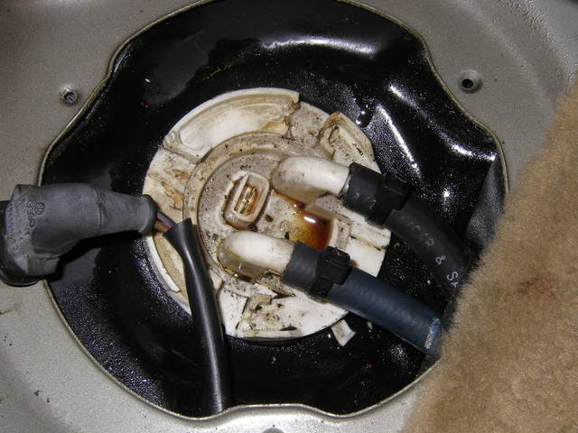

Have u checked your fuel filter & filter neck and tank under your seat? mine were all knackered and my car stunk of petrol when started up till sorted:S all fuel issues, didnt allow anyone to smoke near it in case it blew up, just a suggestion im no mechanic im afraid:)
try removing back seat and undoing the cover plate that hides the fuel sender. on myn smell was greater if tank full as opposed to 1/4 full.
Check for any signs of petrol pooling around the sender, probably the lines not fixed correctly.
Or signs of fuel vapour escaping, normaly looks like a slight damp area, wipe away and comes back. if thats the case probably the oring needs replacing. or could try refitting existing one but they aint expensive and still available from stealer when i tried.
and then as suggested do you know the condition of the filler neck?
pic below shows the pooling clearly and you can see the vapour areas around the outside. As you can see some twonker used cable ties  :banghead:
