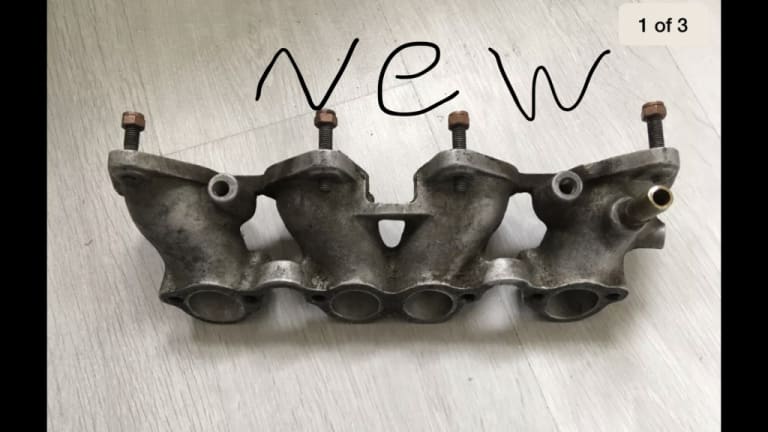

Not sure how to re connect coolant pipe with new manifold
The hole will need to be plugged. It's actually a warm water feed to warm the carb manifold during start up and running until the car is warm.
If I remember correctly the water flow isn't under a great deal of pressure so a bung may do it. A bolt may do it.
