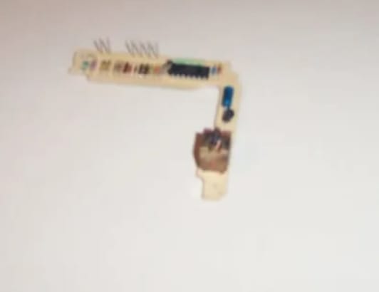

Have you ever had the dash apart? There would be an L-shaped circuit board on the back of the clocks; it has a small buzzer on it (looks like a small relay).
Like this:
http://i288.photobucket.com/albums/ll199/fatrbt/OilWarningPCBoard.jpg

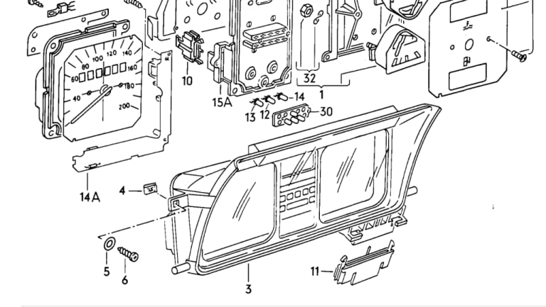

So the blue wrap stuff is just flapping about and the white plug goes over it.
Ones I see online have a black insert over the blue stuff then white clip slides in does have anything to do with it ?
Sent from my Pixel 8 using Tapatalk
12 views (66 Kb)
The mylar (blue circuit is held to the tonque by a shroud that covers the connector and clips to the cluster.  This inturn holds the connector tight to the mylar and the cluster.
I would hazard a guess that it my be floating around in your dash somewhere.
to see what it looks like:
https://www.volkswagenownersclub.com/threads/improving-your-cluster-connections-and-ground.24949/
number 11 pn 321 919 060
